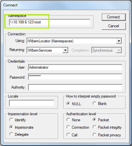

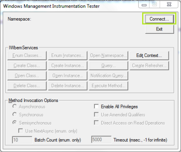

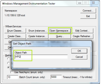

1. Connect from the SAM server or the additional poller server to the Remote Server using wbemtest.exe application
Connect from the location where the problematic node is being polled.
For the namespace specify:
  • IBM and HP devices: \\'RemoteServerIpAddress'\root
  • Dell devices: \\'RemoteServerIpAddress'\root \cimv2
2. Enter the administrator credentials

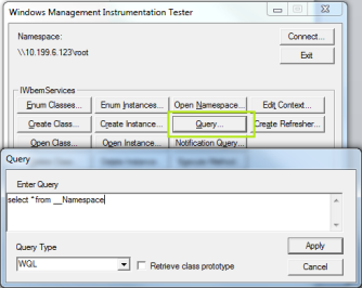

3. Run Query
select * from __Namespace Where Name = 'vendor'
Replace vendor with the specific vendor namespace name:
  • HPQ (for HP)
  • Dell
  • IBMSD (for IBM)
4. If the proper namespace is founded, connect to this namespace
  • For IBM: \\'RemoteServerIpAddress'\root\IBMSD
  • For HP: \\'RemoteServerIpAddress'\root\HPQ
  • For Dell: \\'RemoteServerIpAddress'\root\cimv2\Dell

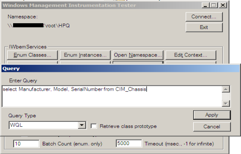

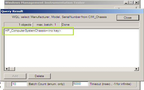

5. Run Query for specific info

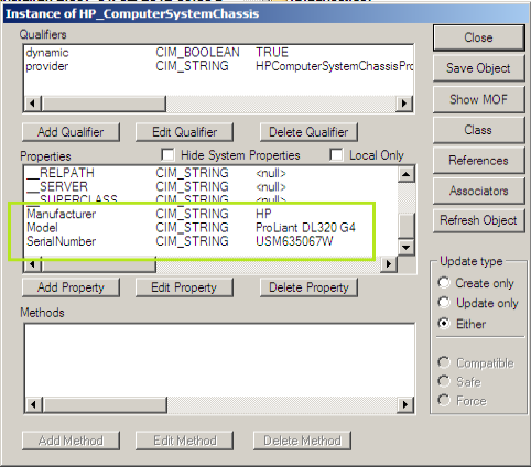

select Manufacturer, Model, SerialNumber from CIM_Chassis
You can use this guide to check other classes polled for Hardware Information's for each manufacturer.
  • If the test wasn't successful please check if the Manufacturer Manager or Agent on Remote machine is configured correctly. Missing namespace and classes in those namespaces for WMI are added by manufacturers Manager or Agent and check its version.
  • If the select for CMI_Chassis class was successful but you still are unable to poll other details about the hardware check the other classes.
    • If they are missing or the information's returned by the remote server are wrong. Try reinstall the Manufacturer Manager or Agent on the polled server.

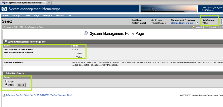

  • If the server in question is HP check in yours OpenManager what provider you have installed and what datastore is used for exposing the Hardware status information. In this case you should have Wbem provider installed and Wbem datastore enabled.
