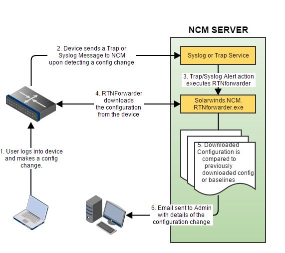

RTCD is made up of a number of different components. To troubleshoot why RTCD is not working, you need to troubleshoot each of these components, to find which link in the chain is broken.
NOTE: The following diagram applies to NCM 2023.2.0 and earlier. In NCM 2023.2.1 and later, RTNforwarder.exe is not launched. The alert action downloads the configuration using a SWIS verb.

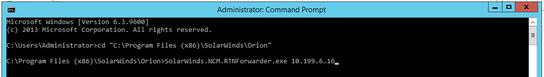

(NCM 2023..2.0 and earlier) Make sure that UAC is set to a low setting or disabled. When RTN Forwarder is executed UAC will prompt for it and will not launch the application.
To test the UAC, launch Command Prompt as Administrator, and navigate to the RTN Forward executable, by default it is located at C:\Program Files (x86)\SolarWinds\Orion\SolarWinds.NCM.RTNForwarder.exe (target IP address of device):
If a prompt comes up, then disable UAC on the server and test again.

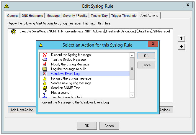

(All versions) Other issues could be the Regular Expressions for any of the configuration of the rule. This can be tested by adding the Windows Event Log:
