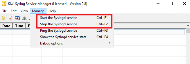

1. Stop the Kiwi Syslog Server service.
  • Click Start > All Programs > Kiwi Syslog Service Manager.
  • To stop the service, Click Manage > Start the Syslogd Service.

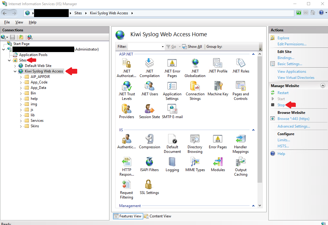

2. Stop the Kiwi Web Access Service (via Internet Information Services (IIS) Manager).
  • Launch IIS.
  • Expand 'Sites'
  • Highlight 'Kiwi Syslog Web Access' > click 'Stop' under the Actions pane at the right panel
  • Launch IIS.
  • Expand 'Sites'

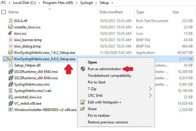

5. Navigate to "C:\Program Files (x86)\Syslogd\Setup"
  • Right-click 'KiwiSyslogWebAccess_9.8.0_Setup.exe' and select 'Run as Administrator'
  • Complete the prompts and ensure to take note of the Administrator password

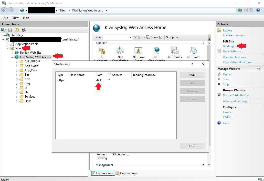

Resolution 3:
The Kiwi Web Access port is being used by another application within the same server.
By default, Kiwi Web Access will utilize port 443 from IIS.
To confirm what port is being used by Kiwi Web Access:
  • Launch IIS.
  • Expand 'Sites'
  • Highlight 'Kiwi Syslog Web Access' > click 'Bindings' under the Actions pane at the right panel
  • The 'Site Bindings' window will appear and show what port is used by Kiwi Web Access.
  • The server administrator should identify if there are other services that are using the port, or decide if they will assign another port for Kiwi Web Access
  • If the Kiwi Web Acces port will be changed, ensure to restart both the Kiwi Syslog service and the Kiwi Web Access service.
