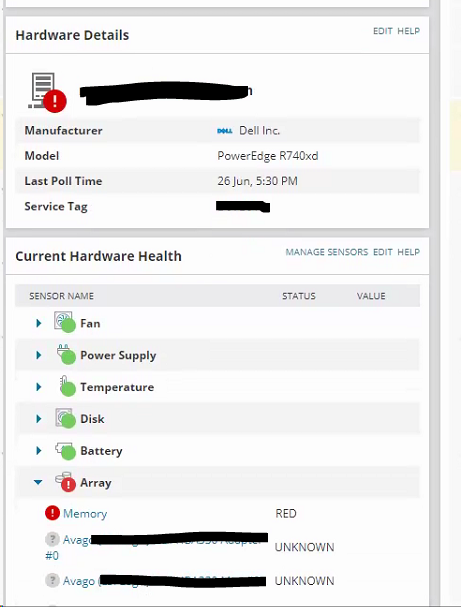

  • Sometimes a hardware sensor for hard disk, fan, or other hardware item is identified in the Orion Web Console as being in a critical or warning state.
  • Even when the item is replaced, the hardware health sensor can still display as critical or warning within the Orion Platform. This is a common occurrence when ESX hosts are polled through vCenter. SAM polls this information via the VMware API which can fail to update itself or can provide a false positive.

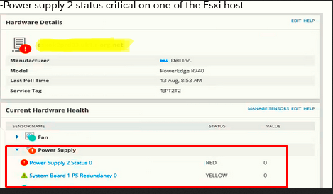

For example, the ESXi host shows power supply status critical:

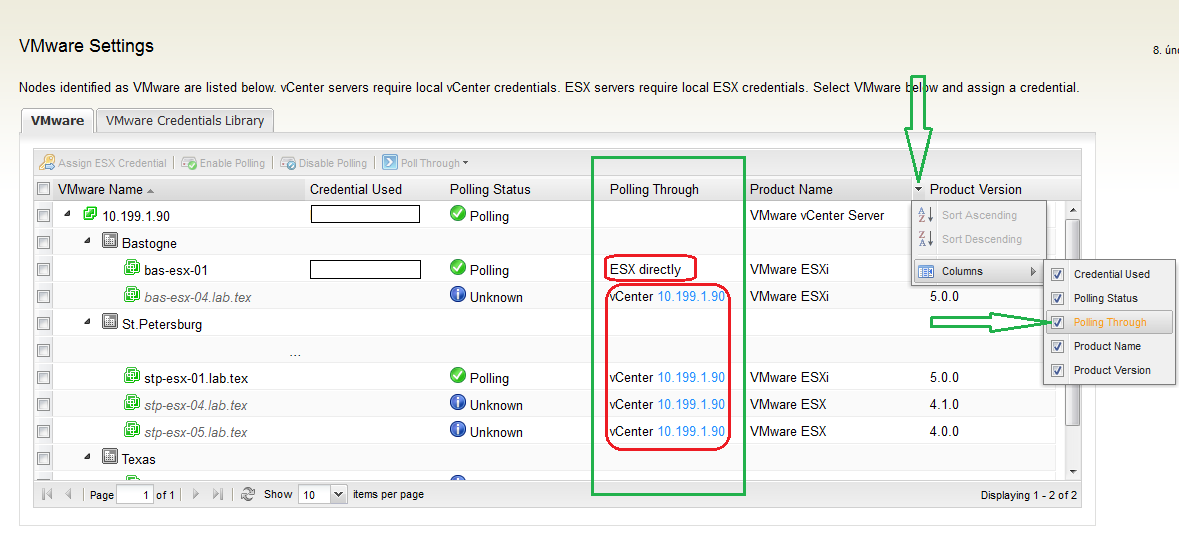

1. Verify if your ESX host is polled through vCenter or Polled Directly by checking on Virtualization settings page.
To confirm this information, go to  Settings > Virtualization Settings.

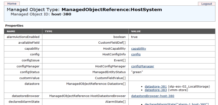

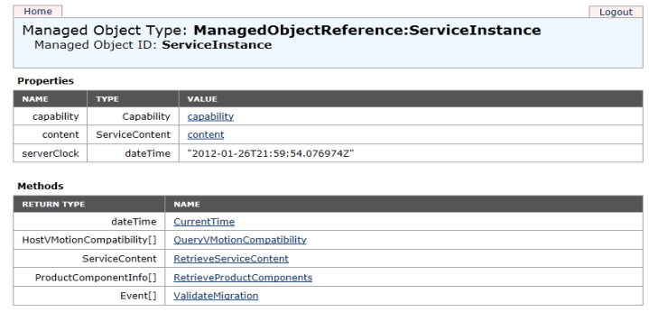

2. Access the VMware API:
  • Access the VMware API by going to: https://your_vCenter_server/mob
    • Replace your_vCenter_server with either the IP address or host name of the server to access.
  • This will open the Managed Object Browser page.
3. Locate the ESX host object.
  • Select the following properties:
    • Content > rootFolder > childEntity > select datacenter > hostFolder > childEntity > select domain > host > select ESX host
  • You should see page similar to this:

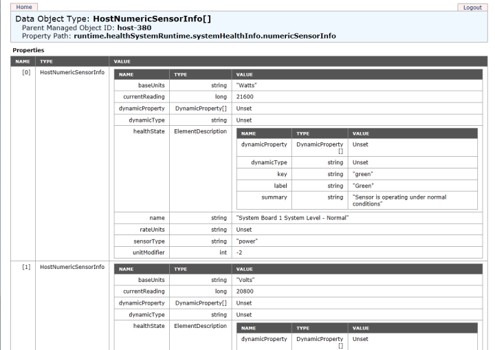

4. Locate the ESX host's hardware health information
  • Go to runtime -> healthSystemRuntime -> systemHealthInfo -> numericSensorInfo

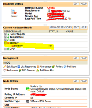

  • ESX Guest showing  "Memory Critical" issue.
    • Please Note :  There are  more than numericSensorInfo properties.  Please check the one which is relevant to the Warning / Critical Message you are seeing to your ESX,
  • You can view the Memory Critical issue using the following properties:
    • runtime -> healthSystemRuntime -> hardwareStatusInfo -> memoryStatusInfo

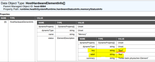

The following error is displayed in SAM web console
However, when we check the host itself, there appears to be no issue.
Researching further into the VMware API, we can see that it is reporting a 'Red' Status, resulting in the Warning message from the SAM Web Console

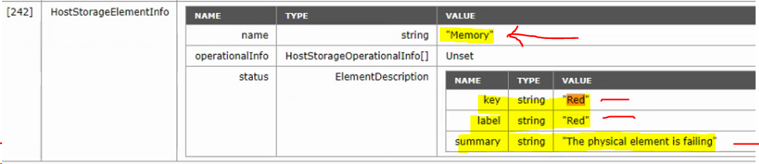

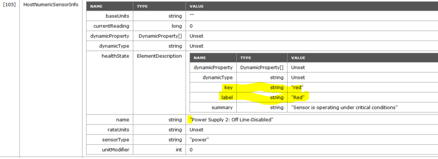

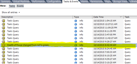

  • A power supply has been replaced, however the power supply status is still showing RED.
When checking the host via vCenter there appears to be no issue.
However, SAM is reporting that there is an issue with one of the Power Supply Units.
Checking the VMware API where SAM is polling, we can see there is a 'Red' warning message flagged in the API.
