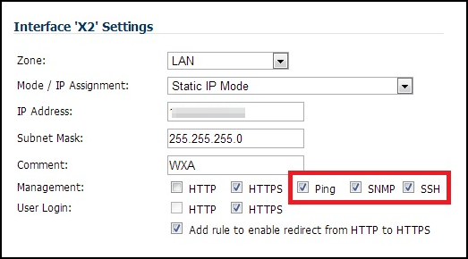

  • Some firewall is required to enable ICMP/SNMP on an interface level. Even if you have configured SNMP, it should still be allowed on the interface level. (Below is an example from SonicWall Firewall) **Do not use the @ sign in the SNMP community string.

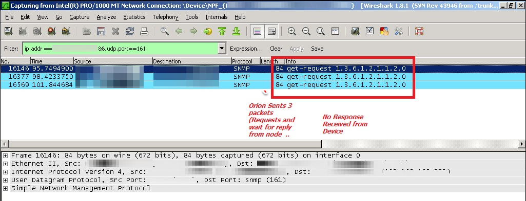

  2. Start capturing data from the correct interface, using a capture filter of the node IP address and port 161

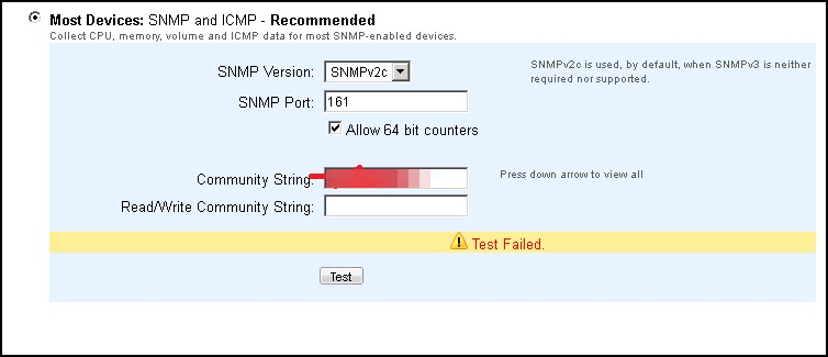

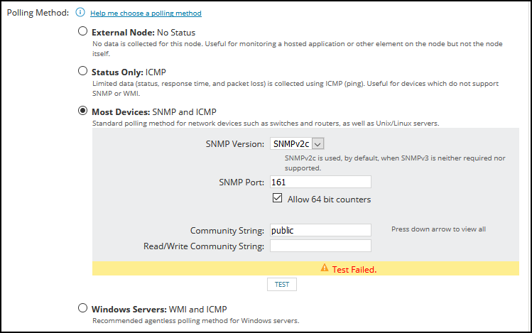

  1. Go to the SolarWinds Web Console page and try to add the node. You will get the Test Failed message:
  2. Check Wireshark and verify the response from the node. Orion sends 3 requests and if no response is received from the node, you will get the Test Failed message.
This is to confirm that the SolarWinds Platform has not received any response back from the node, and the Result is TRUE as Failure

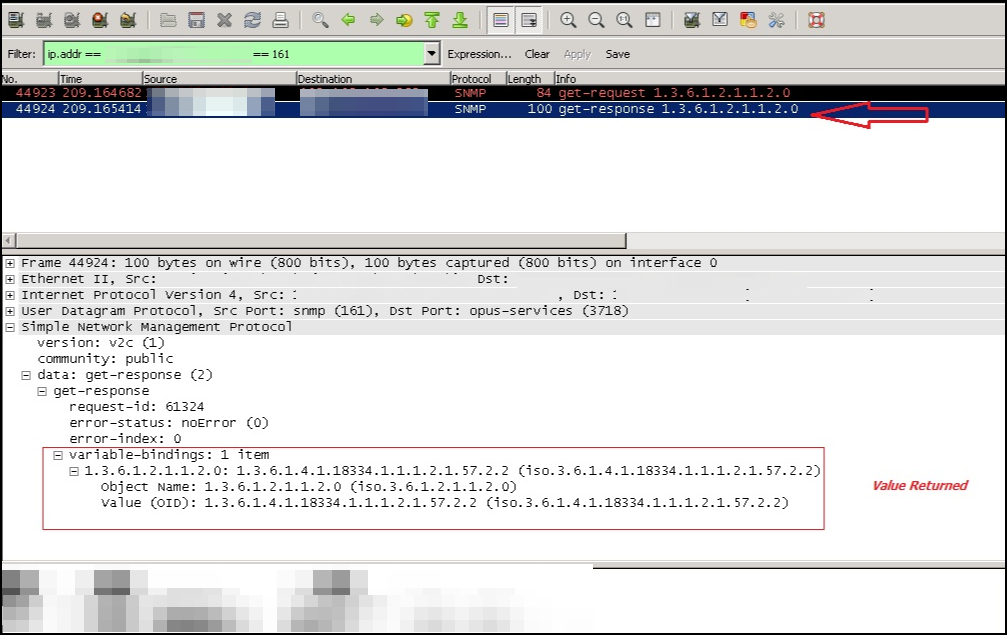

The requirement to pass the test

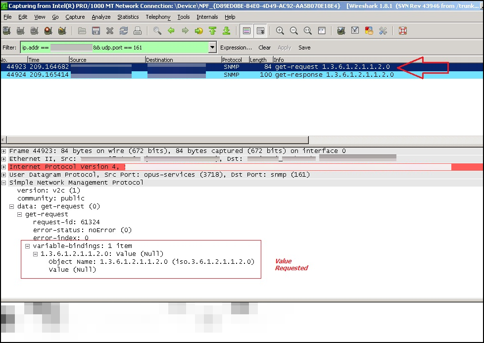

SolarWinds Platform sent get-request 1.3.6.1.2.1.1.2.0 to determine the SNMP connectivity which was responded by the Node with valid Information:
In the Response packet, the value should be returned in the packet.
**This should not be NULL. If there is no value returned in the packet, the test will fail.**
