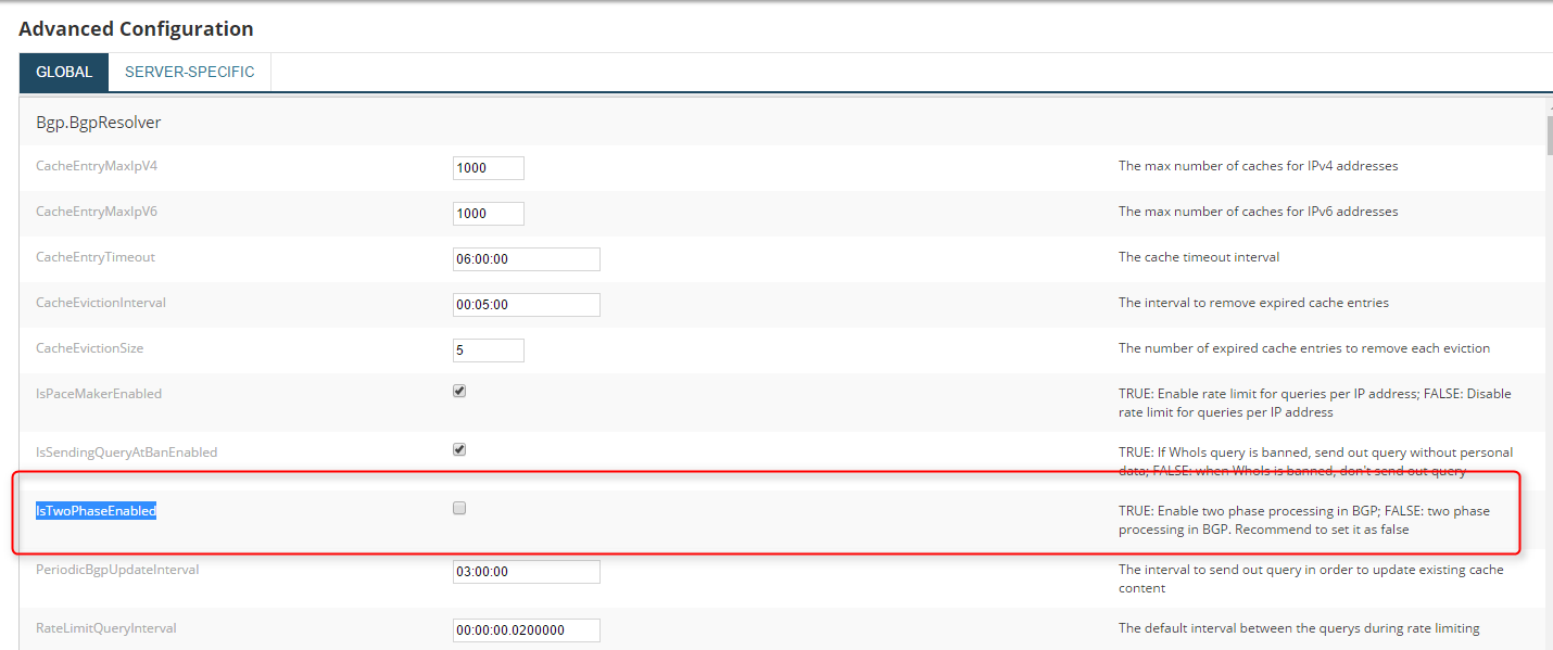

- Enable the IsTwoPhaseEnabled option via in the Orion Advanced Configuration page
http://<your server>/Orion/Admin/AdvancedConfiguration/Global.aspx. Try adding a new path to a different address to ensure that the new option is working. If this does not help, proceed to step 4.

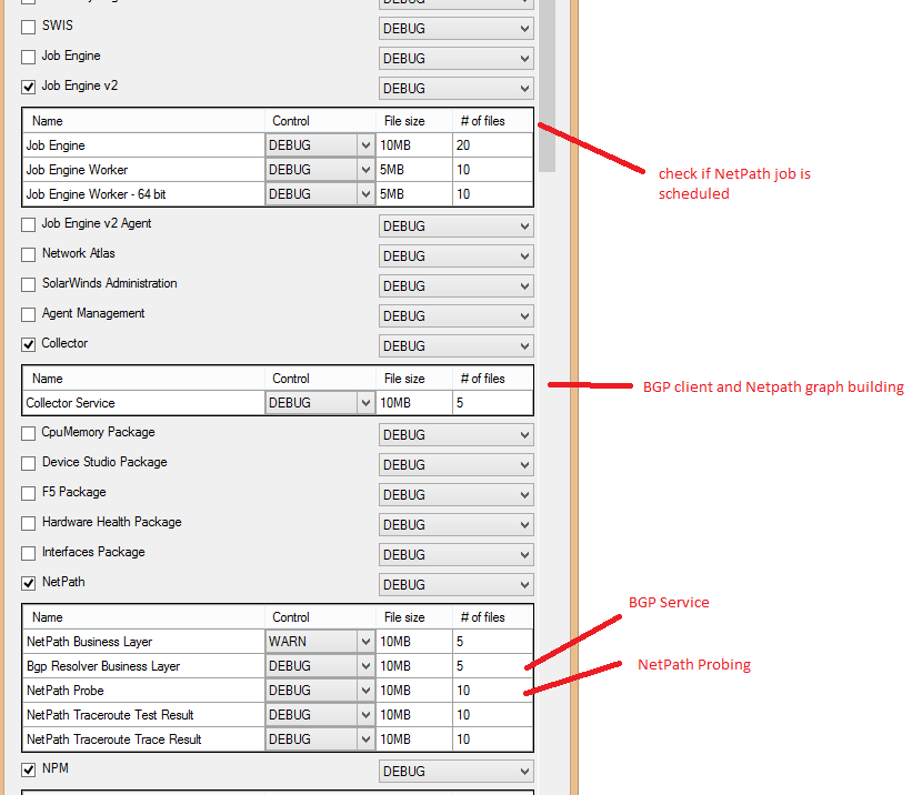

- Enable Log Debugging and send logs to support.
