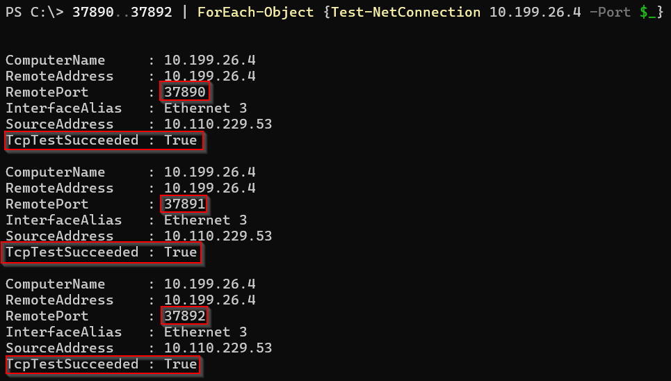

SEM Agent Connection Ports:
If the service is running, but the SEM agent is still not showing, or is showing as disconnected, verify a firewall is not blocking your connection. The SEM agent relies on the following ports to communicate with the SEM appliance. Refer: How to verify SEM agent service and port status
Ensure you have the proper exceptions in place for any firewall between a SEM agent and the SEM appliance.
  • Verify the SEM agent is running the current version of the software. The agent version typically follows the SEM version, with some exceptions.  Example: (SEM 2024.2 uses 2024.2 Agent version )
  • 37890-37892: Traffic from SEM agents to the SEM appliance.
    • Use Powershell to Test via the Test-NetConnection command:
      • 37890..37892 | ForEach-Object {Test-NetConnection <SEMIP> -Port $_}
  • Upon Failure test:
    • Disable the anti-virus and re-install the agent per the un-install/re-install above.
    • Disable the Windows firewall for all 3 profiles (domain, public, private).
      If the public or private profile is enabled, event though the domain is disabled, communications may be blocked.
    • Look into the software installed on this computer for any possible resource conflict.

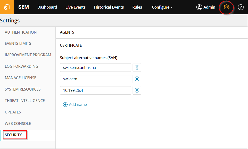

1. Reset the SEM Agent Certificate (See the steps below on how to reset)
2. Check the SEM Settings > Security > Agents > Certificate > Subject Alternative Names (SAN).  Ensure the FQDN, Hostname and IP are configured.
      a - Log into the SEM Webui
      b - Navigate to Settings > Security > Agents > Certificate
       c - Edit or add FQDN, Hostname or IP

3. Check the SEM Settings > Security > Agents > Certificate > Subject Alternative Names (SAN).  Ensure the FQDN, Hostname and IP are configured.
