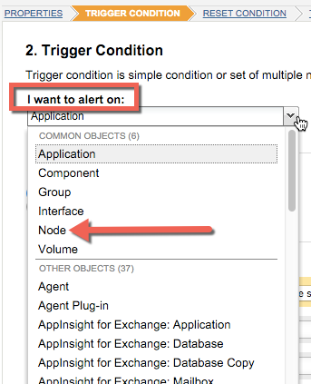

Ensure that when configuring alert actions to alter Node status, the trigger conditions are linked to nodes. Specifically, set the alert criteria under "I want to alert on" for "Node" instead of "Custom Node Poller" to successfully achieve the desired status changes. Update the configuration accordingly to align with node-related trigger conditions.
