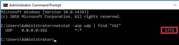

  1. Open CMD and run the command below
  2. Take note of the PID listed in the right side of the result
  3. Open Task Manager and under the Services tab, identify the service using the PID
  4. Uninstall(or disable) the service
