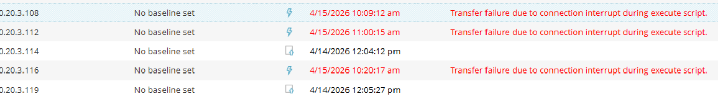

Transfer failure due to connection interrupt during execute script in NCM
Executing a script from NCM Web Console fails with error message: Transfer failure to connection interrupt during execute script
