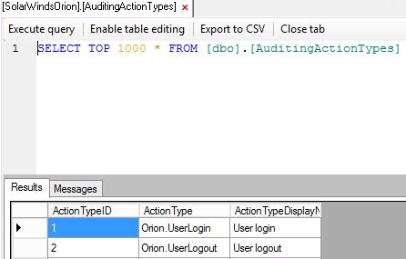

Database View
  1. RDP to the SolarWinds Platform Server.
  2. Launch the Database Manager.
    Note: Before you proceed with the Database Changes, verify that you have a backup of your SolarWinds Platform Database.
  3. Locate and double click the table below:
    AuditingActionsTypes
    Refer to the following image:
  1. Note the ActionTypeID (1 and 2 for the user login and user logout respectively).

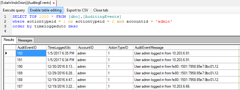

  2. For example, we would like to trace the login activity of the 'Admin' account. Execute on the following query:
    SELECT TOP 1000 * FROM [dbo].[AuditingEvents]
    where actiontypeid = 1 or actiontypeid = 2 and accountid = 'admin'
    order by timeloggedutc desc
  3. All activity of that particular user should be displayed as shown in the screenshot, latest first.
