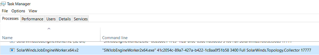

If the timeout for the Topology SNMP polling job is too long, it may lead to high memory usage.
(Example of a Topology Job Engine worker in Task Manager)
