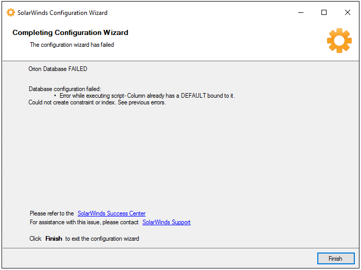

  • This article provides more details and steps to fix an issue that occurs when running the Setup Wizard and fails with the following error:
Database configuration failed: Error while executing script Column already has a DEFAULT bound to it.
  • The following errors may be observed in the ConfigurationWizard.log:
[4] ERROR DBConfigProcessor - Error while executing script - Column already has a DEFAULT bound to it.
Could not create constraint or index. See previous errors..
 Error details: System.Data.SqlClient.SqlException (0x80131904): Column already has a DEFAULT bound to it.
Error Number:1781,State:1,Class:16
 Failing Sql command:
ALTER TABLE [dbo].[Accounts] ADD  CONSTRAINT [DF_Accounts_ToolsetIntegration]  DEFAULT ('Y') FOR [ToolsetIntegration]

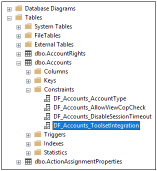

2. In the SQL Server Management Studio, run the following query below to discard the constraint:
Note: Make sure you have a backup of your database. In the query below you may change the constraint name according to what was found in the ConfigurationWizard.log
Additional Note: Look at the constraint in SQL Server Management Studio before running this query and adjust the constraint name as necessary. You may see a slightly different constraint name such as DF_Accounts_ToolsetIntegration_57
IF EXISTS (SELECT 1 from sys.objects where name = 'DF_Accounts_ToolsetIntegration')
ALTER TABLE [dbo].[Accounts] DROP CONSTRAINT [DF_Accounts_ToolsetIntegration]
3. Alternatively, you can manually delete this constraint in the SQL Server Management Studio:
  • Open the SQL Server Management Studio (SQL Server)
  • Go to the SolarWinds database > Expand Tables > dbo.Accounts > Right-click on  the constraint > Delete.
(Screenshot collected from MS SQL Server Management Studio on 10/10/2022)
