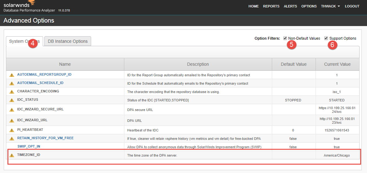

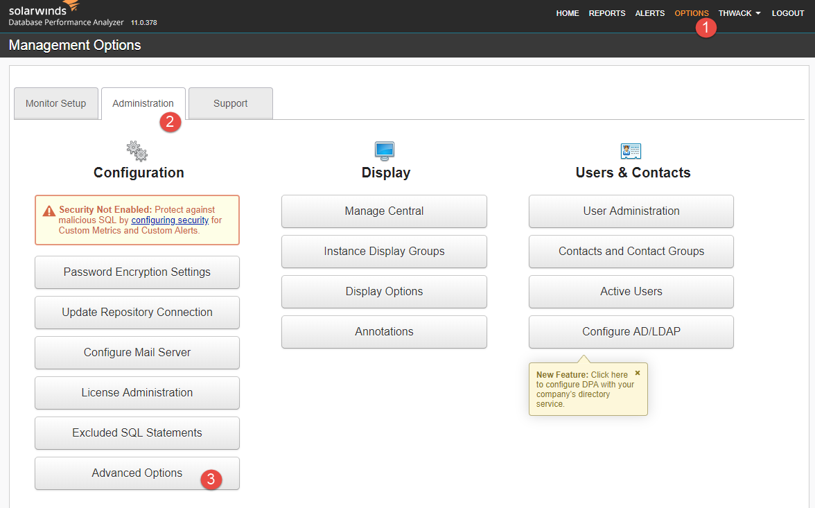

Verifying the Change
To verify the time zone change has taken effect you can log into DPA's web console and navigate to options -> Administration tab -> Advanced options -> System options tab -> Click both the Option Filters: “Non-Default Values” and also “Support options”
At the bottom of the screen will be an item TIMEZONE_ID.
Another option is in the logs files in <installDir>/iwc/tomcat/logs/system.log there is a line like the following.
user.timezone: America/Chicago
Note:  If the time zone has a typo, DPA uses the default time zone of the host computer.
