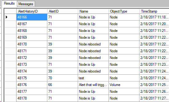

Depending on which table you are looking at, you might have to change the query depending on the name of the column. See example below:
Select [AlertHistoryID], [AlertID], [Name], [ObjectType], [TimeStamp]
FROM [dbo].[AlertHistoryView]
To recreate this result, use the query above on the database manager.
Note: The timestamp on the image below is for the local time of my Orion server which is Manila time.

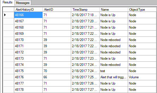

If you would like to have a column where it would convert the time to a different timezone, use the query below:
SELECT [AlertHistoryID], [AlertID], [Name], [ObjectType], DATEADD(hour, -8, [TimeStamp]) as [TimeStamp]
The query above needs to set the local time(Manila time) on the database as UTC time which is -8 and the result would be this. You can convert the time to any time zone using the query above as long as you adjust the hour added as you see fit.
