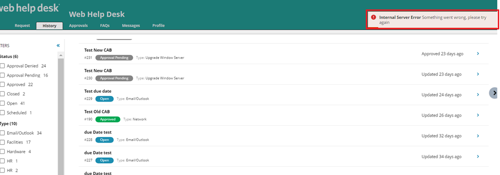

In WHD 12.8.3, SolarWinds added a column “due_date” in the JOB_TICKET table. This change results in “due_date” being null for existing tickets, making them inaccessible on the Client’s UI and causing an error message to be displayed.
Error message:
Internal Server Error Something went wrong, please try again.
Workaround 1: Once the affected ticket has been opened and saved from the Tech UI, it can be accessed from the Client UI.
Workaround 2: To quickly fix this issue from the backend, you can use the attached SQL query. that should resolve all affected Tickets from seeing this issue.

Once either of the workarounds are applied the older ticket will be accessible through the Client’s UI.
