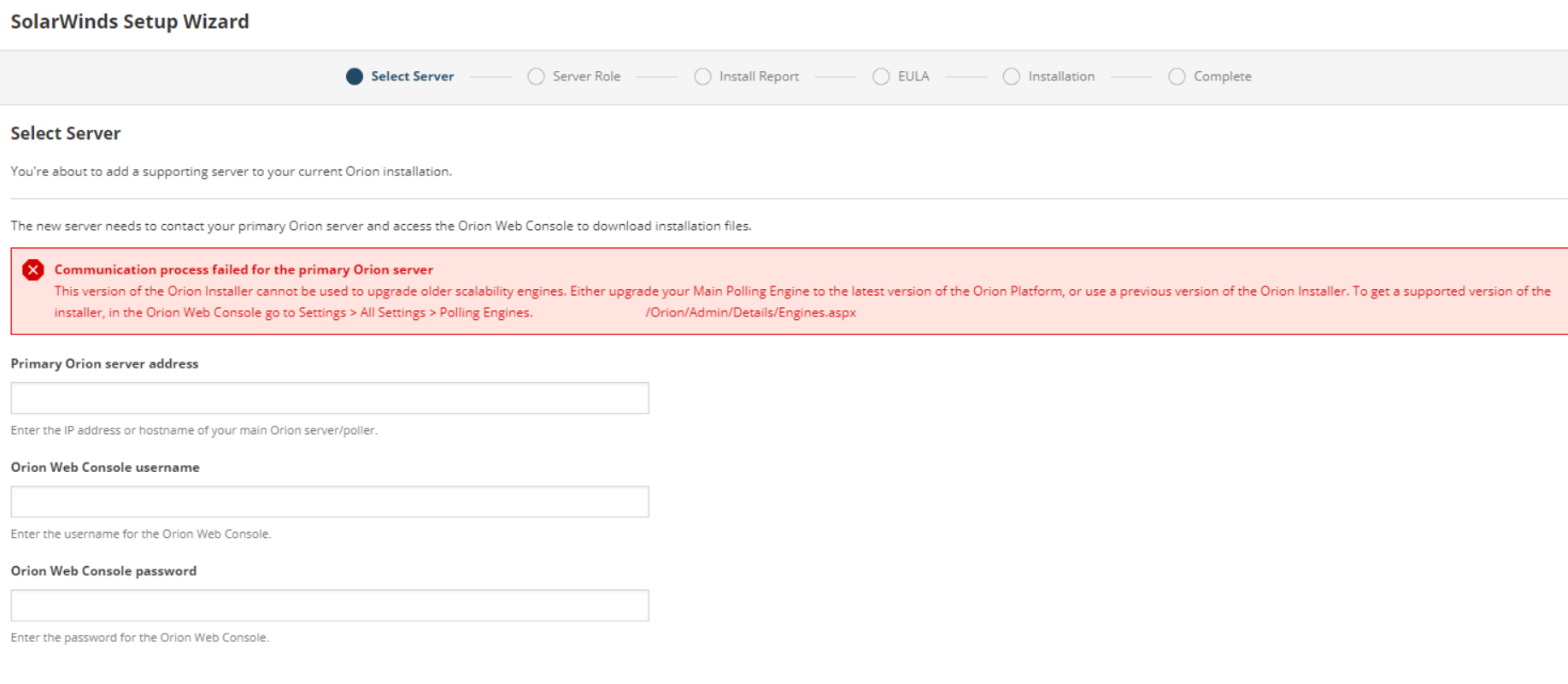

This version of the SolarWinds Installer cannot be used to upgrade older scalability engines
When running the installer to deploy an additional polling engine, additional web server, or High Availability standby server, a 'This version of the SolarWinds Installer cannot be used to upgrade older scalability engines' error message pops up stopping the installation.

When running the installer to deploy an additional polling engine, web server, or High-Availability standby server,staller cannot be used to upgrade older scalability engines' error message pops up, a 'This version of the Orion In stopping the installation. This message persists even after having the latest versions of the SolarWinds Platform.
The AdministrationService.Client.log will also contain the error message below:
ERROR (null) SolarWinds.InformationService.Contract2.InfoServiceProxy - An error occurred opening a connection to the Orion communication service. System.ServiceModel.Security.MessageSecurityException: An unsecured or incorrectly secured fault was received from the other party.
Communication process failed for the primary Orion server This version of the Orion installer cannot be used to upgrade older scalability engines.
Or error message in the installer itself:
Communication process failed for the primary Orion server  This version of the Orion Installer cannot be used to upgrade older scalability engines. Either upgrade your Main Polling Engine to the latest version of the Orion Platform, or use a previous version of the Orion Installer. To get a supported version of the installer, in the Orion Web Console go to Settings > All Settings > Polling Engines. http://<Orion servername>/Orion/Admin/Details/Engines.aspx

Use the built-in or default SolarWinds 'Admin' account credentials to connect to the main polling engine. Please refer to the screenshot below:
Orion installer error
You should be able to get past this error message when you use the default SolarWinds Platform 'Admin' account and continue with the installation.
