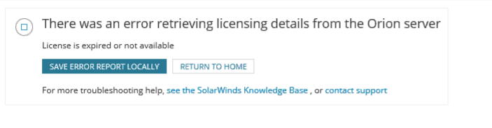

The following error is displayed on the Additional Web Server or on the Orion Web Console after upgrading NPM, or after migrating licenses:
There was an error retrieving licensing details from the Orion server
License is expired or not available
The following error is returned after you click the SAVE ERROR REPORT LOCALLY:
Message: License is expired or not available

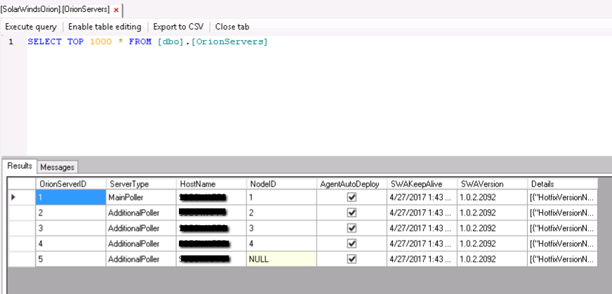

Check Database Table
Verify the Additional Web Server (AWS) is in the 'OrionServers' table in the SolarWinds Orion Database:
  1. Establish a remote connection to the Primary Polling Engine.
  2. Open Database Manager, and then select the following table:
    OrionServers
  3. Run the Configuration Wizard on the Additional Web Server if the hostname is not displayed on the table.
    This will create a new row on the OrionServers table.
  4. Apply the license through the Orion Web Console's License Manager page.
