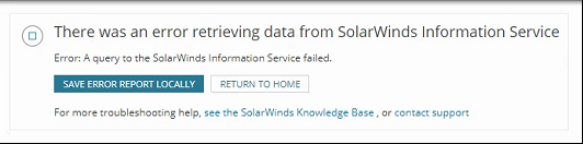

When opening any objects, such as http://<NPM server IP>:<port>/Orion/NetPerfMon/NodeDetails.aspx?NetObject=N:XX, the following error appears:
There was an error retrieving data from SolarWinds Information Service
The following information shows in the Event logs:

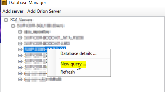

  6. Click Start > All Programs > SolarWindsOrion > Advanced Features > Database Manager. Once there, follow the following steps:
    1. Click Add Default server.
    2. Expand your SQL server and locate your SolarWinds database.
    3. Right-click your SolarWinds database and then select New Query.

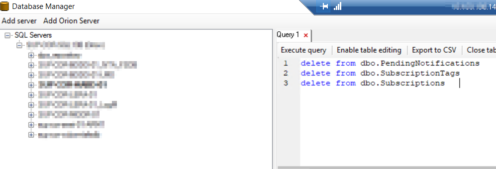

    4. On the right field, paste the following:
      -- disclaims all warranties including, without limitation, any implied
      -- warranties of merchantability or of fitness for a particular purpose. The
      -- risk arising out of the use or performance of the scripts and documentation
      -- stays with you. In no event shall SolarWinds or anyone else involved in the
      -- creation, production, or delivery of the scripts be liable for any damages
      -- whatsoever(including, without limitation, damages for loss of business
      -- profits, business interruption, loss of business information, or other
      -- pecuniary loss) arising out of the use of or inability to use the scripts
      -- or documentation.
      DELETE FROM [PendingNotifications]
      DELETE FROM [SubscriptionTags]
      DELETE FROM [Subscriptions]
    5. Note: This clears out all the temporary data from the Subscriptions table.
