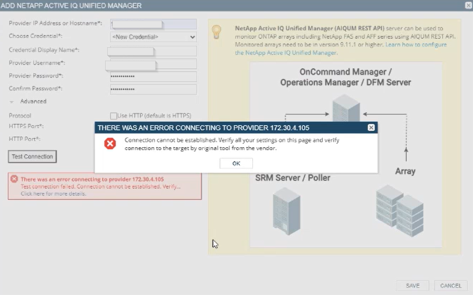

When adding a NetApp Active IQ Unified Manager (AIQUM REST API) provider in Storage Resource Monitor (SRM) via Add Storage Device, the Test Connection fails with:
Storage Resource Manager fails to connect to AIQUM due to one or more of the following:
  • Incorrect provider type selected
  • Incorrect protocol, port, or hostname
  • Network or firewall restrictions
  • Expired or invalid SSL certificate
  • Incorrect AIQUM user role
  • API Gateway feature disabled in AIQUM
  • Unsupported ONTAP variant (cloud-hosted)
