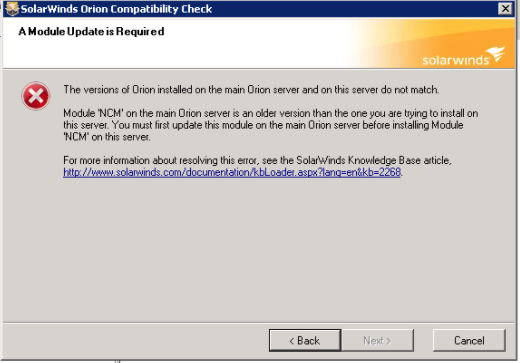

The versions of Orion installed on the main Orion server and on this server do not match
The following error occurs when installing Network Configuration Manager (NCM) on an Additional Polling Engine (APE) even when the main poller is already on the same version you are currently using: A module Update is Required The versions of Orion installed on the main Orion server and on this server do not match. Module 'NCM' on the main Orion server is an older version that the one you are trying to install on this server. You must first update this module on the main server before installing Module 'NCM' on this server.
11/29/2018 10:55 PM
5/16/2019 2:49 PM
The following error occurs when installing NCM on an APE even when the same version of NCM on Primary Polling Engine has already been installed:

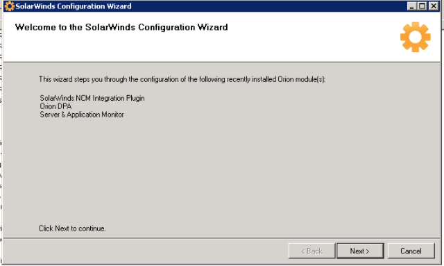

The Configuration Wizard is not being executed after upgrading the NCM module on the Primary Polling Engine which can be seen after executing Configuration Wizard, as below:
  1. Log in to the Primary Polling Engine using an administrator account.
  2. Run the Orion Configuration Wizard under Start > All Programs > SolarWinds Orion > Configuration and Auto-Discovery > Configuration Wizard.
  3. Once the Configuration Wizard is finished on the Primary Polling Engine, execute the NCM installer in Additional Polling Engine and follow the process.
