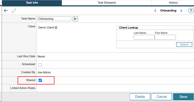

Option 1:
Contact the Tech who created the Tasks and set the Tasks to Shared.
a. Go to Setup>Tickets>Tasks
b. Open the missing Tasks and set Shared to Yes.
c. Save.
