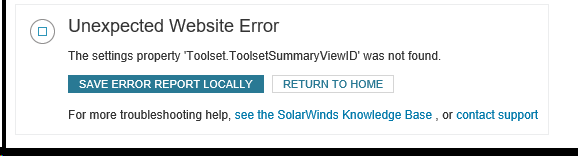

How to fix the "settings property Toolset.ToolsetSummaryViewID was not found" error when you log in to the Orion Web Console.

This article provides information on how to fix the below error you get when you log in to the Orion web console.

  • An old version of DLL's from Toolset application interferes with Orion.
  • A known issue in 2022.3 RC3
Resolution 1:
  1. Repair or completely remove Toolset from Add / Remove programs.
  2. Run Orion Configuration Wizard when prompted.
Resolution 2:
  1. Fixed in 2022.3 GA. If you are running an RC version, please upgrade either through the web console at Settings > My Orion Deployment > Updates or by using the installer available in the customer portal.
