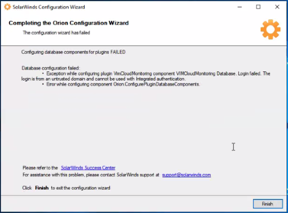

Running Configuration Wizard (CW) on the Main Polling Engine (MPE) other Additional Polling Engines (APEs) completed. Adding another APE on a different domain, the Configuration Wizard fails with the message: Database configuration failed: Exception while configuring plugin VimCloudMonitoring component VIMCloudMonitoring Database. Login failed. The login is from an untrusted domain and cannot be used with Integrated authentication. Error while configuring component Orion.ConfigurePluginDatabaseComponents.

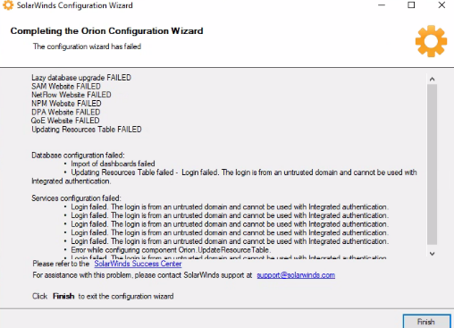

Configuration Wizard fails with error:
OR
Services configuration failed:
•  Login failed. The login is from an untrusted domain and cannot be used with Integrated authentication.
•  Error while configuring component Orion.UpdateResourceTable.
