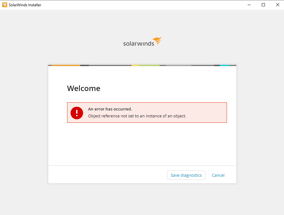

The communication to the main polling engine server failed. "Object reference is not set to an instance of an object" when installing on APE
This article provides a step-by-step process on how to resolve an error that has occurred. Object reference is not set to an instance of an object when installing SolarWinds on the Additional Polling Engine on version 2024.4 and below.
10/29/2024 12:27 AM
11/14/2025 5:53 PM
Customers will encounter the error, An error has occurred. Object reference is not set to an instance of an object when installing SolarWinds on the Additional Polling Engine on version 2024.4 and below.
Upon checking the Administration service.Client.log, you will see the error below.
