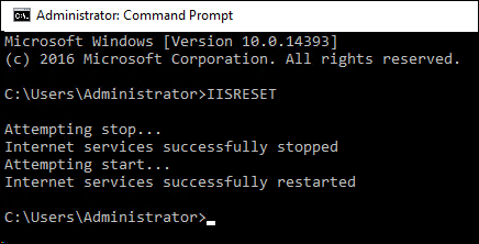

  4. If the issue persists:
    1. Edit the IIS HTTPS binding, remove any hostname you may have set from the Hostname field as per the screenshot
  1. Perform IISRESET in CMD as administrator.
  1. Check again to see if the issue has been resolved.
