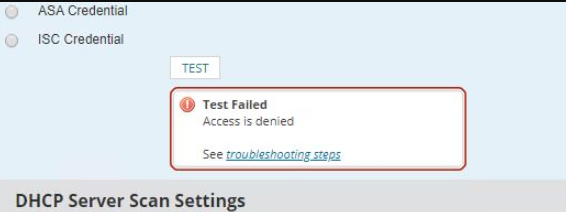

"Test failed Access is denied" when adding a DHCP server in IPAM
Cannot successfully add a DHCP server due to failed credentials. Getting Test failed: Access is denied when you test the credentials.
12/4/2019 6:30 PM
9/8/2025 4:07 PM
Unable to add a new DHCP server in IPAM due to Test failed error when testing the credentials.
Test failed
Access is denied
