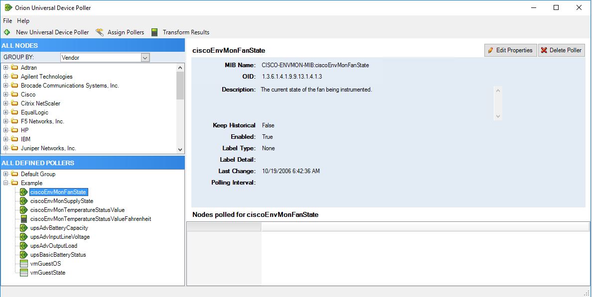

  1. Open Universal Device Poller (Green Leaf icon) on the Orion Application server
  2. Select the Poller you want to test.

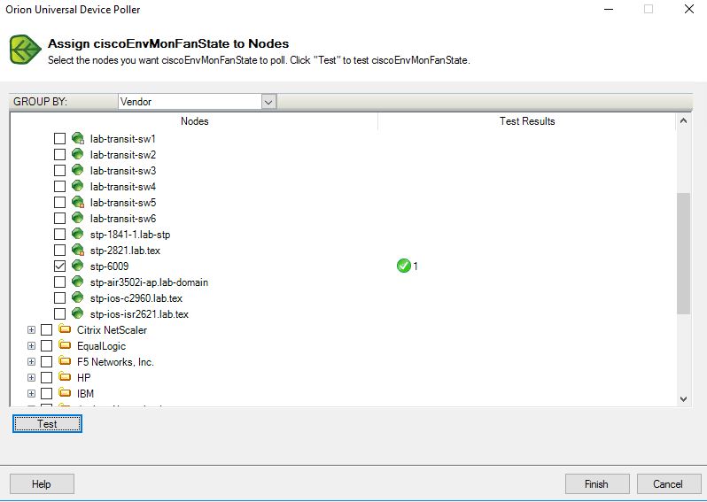

  3. Right click and select Assign.

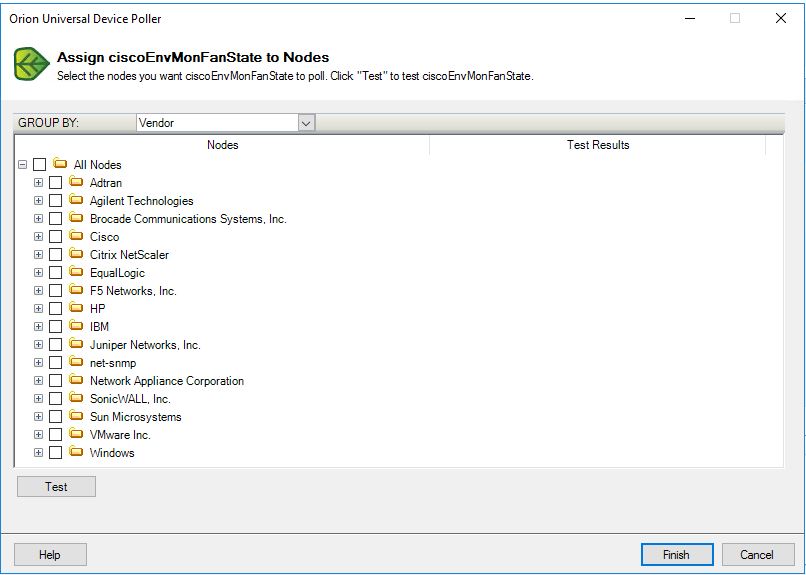

  4. Change the drop down to Troubleshooting so that you can see all your nodes.
  5. Find the nodes that it is assigned to.
  6. Click the Test button on that window at the bottom.
  7. From the Above you can see that it worked and pulled in the value of 1.

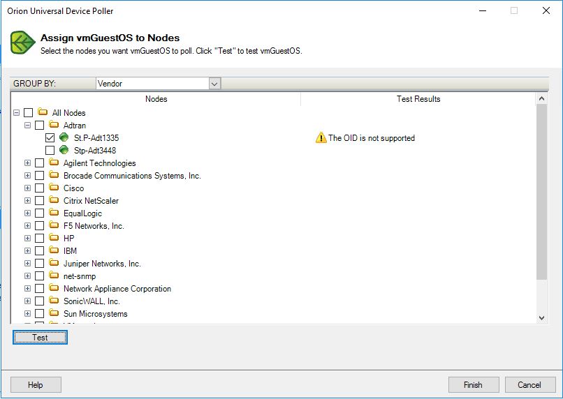

    This is what you do not want.
  8. If you get the above test result showing The OID is not supported,
    a. Do an SNMPwalk by going to C:\ProgramFiles(x86)\Solarwinds\Orion\SNMPwalk.exe.
    b. Fill out the screen with the ip address and what SNMP version and the community string.
