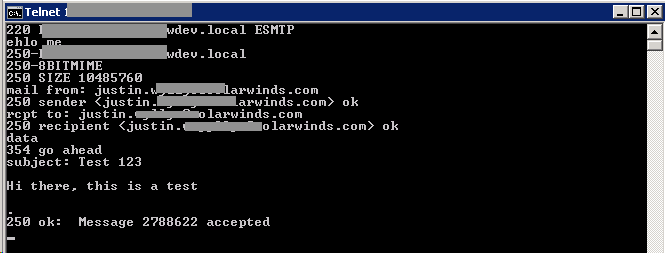

      1. open command line (START > Run > CMD > Enter) and enter following command
        telnet 10.110.108.21 25
        if connection is established you shall be presented with following:
      2. Type the following command to send a test email and press enter
        ehlo me
        mail from: <sender-email> <enter>
        rcpt to: <recipient-email> <enter>
        data <enter>​​​​
        • subject: Test 123 <enter>
        • <enter>
        • Hi there, this is a test <enter>
        • Finally, to finish the email, type a period (.) and <enter>
          • You should get a 250 OK - that means it was successful
          • If you do not get a 250 OK, and get something else, refer to this guide: http://www.greenend.org.uk/rjk/tech/smtpreplies.html
          • This indicates the issue is likely on the SMTP server (likely not running an open relay or the user doesn't have a mailbox)
        • The recipient should then receive an email:

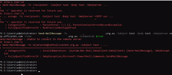

    For testing through PowerShell
    • RDP to your Orion Server.
    • Open Powershell and run the following.
      • Bind the credential to authenticate to SMTP server to a PS Variable
        $cred = get-credential
      • Now we will use PowerShell to send the email
      • Send-MailMessage -To <recipient> -Subject test -Body test -
        SmtpServer <SMTP server> -From test@noreply.com -Credential $cred
