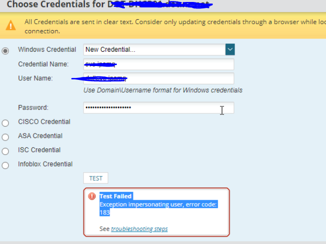

Test Failed on credentials when adding DHCP server in IPAM
This article will explain what to do when the test failed on the credentials when adding DHCP, receiving the below error: Test Failed - Exception impersonating user, error code: 183
8/10/2021 8:54 AM
2/26/2025 3:47 AM
The above image  showing test failed and the error details
