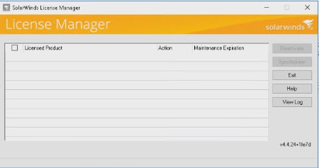

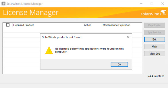

The SWI License Manager will either display no licenses or return an error when launching, stating "No licensed SolarWinds applications were found on this computer." (Note: this applies to SWI License Managers on version 4, as shown in the lower right. Any versions higher than this will have no effect using these resolution steps.)

  2. If you run the License Manager again, you will see no complaints.
