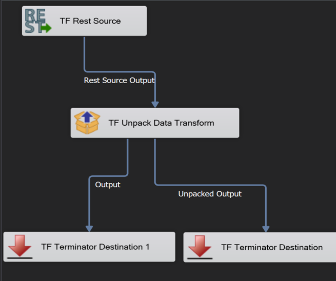

  1. Once that is configured, it is time to bring in the Unpack Data Transform, below is an example of how your Data Flow should look. Please note that I am using a Terminator Destination, in your scenario you would most likely use a different destination i.e.) Upsert, OLE DB, or another destination.

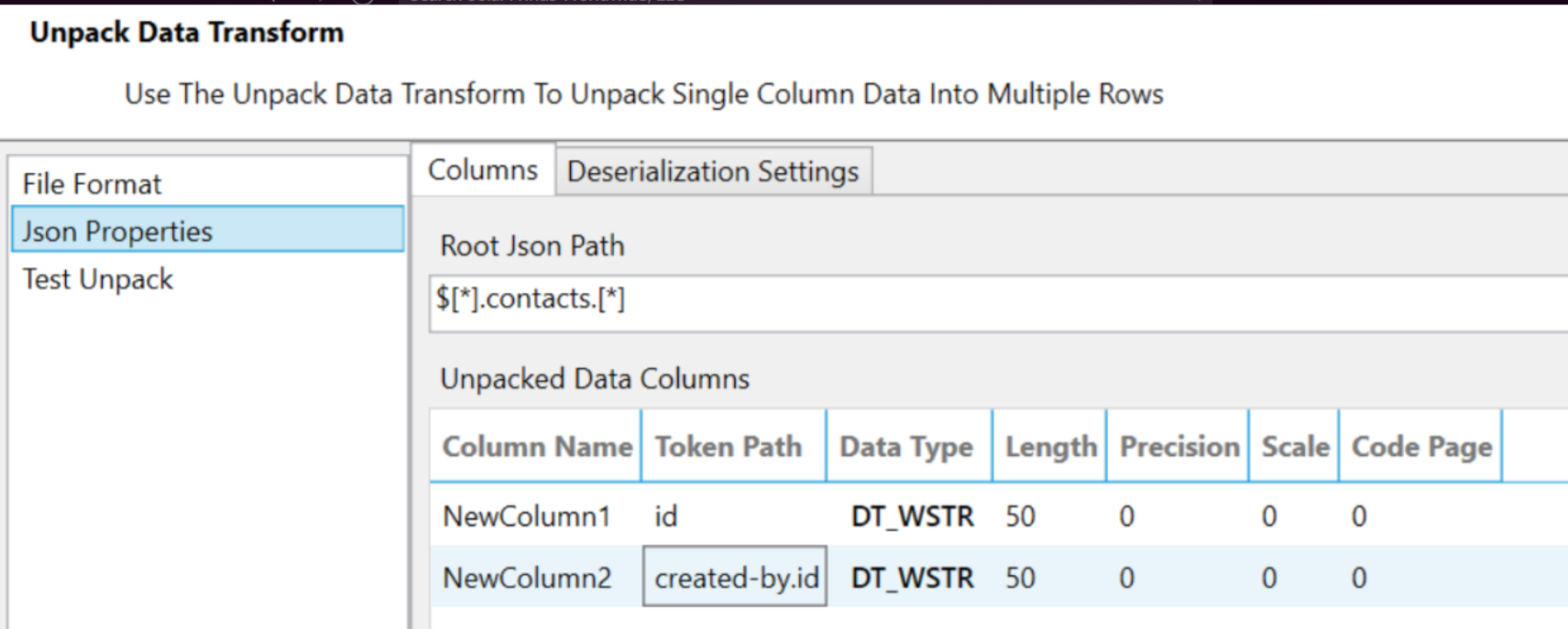

  2. The File Format tab is where we tell the component which column contains the packed data, as well as what columns to include in the unpacked data. If you had multiple columns of packed data you would include all the columns, except the column being parsed in this Unpack Data transform, as part of the unpacked data.
  1. The JSON Properties tab is where we will parse the data, similar to how you configure the REST Source to parse the return. My screenshot below shows that I am only parsing the packed data into one column but, it is important to note that you can create more than one column from the packed data column.

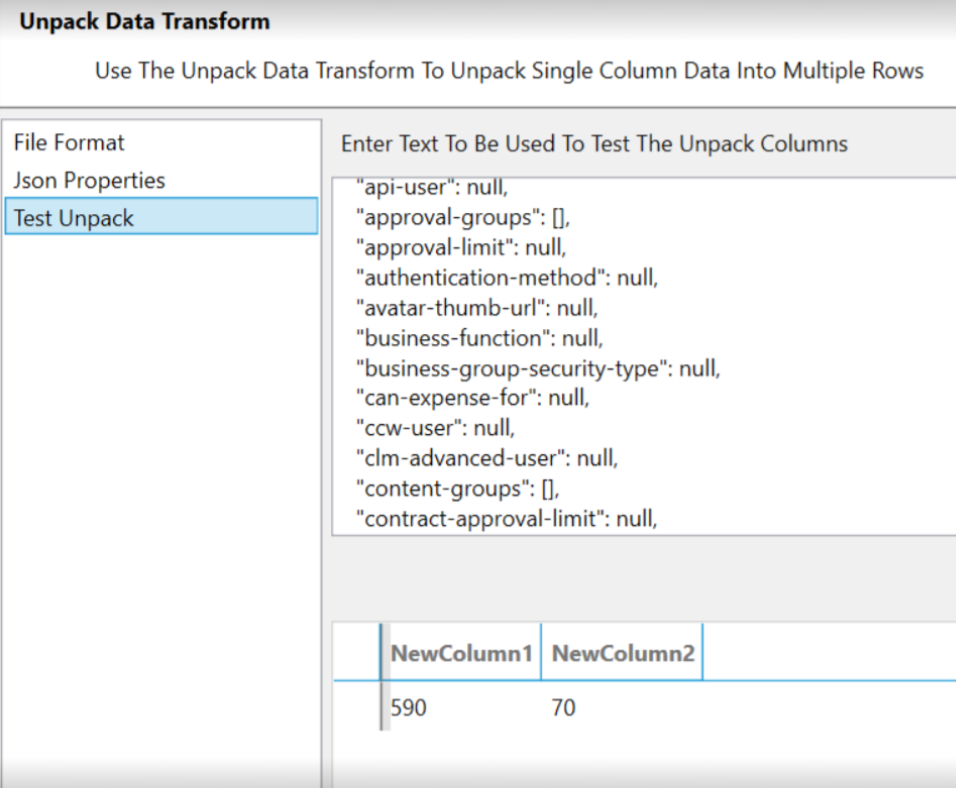

  1. To test the unpack under the Test Unpack tab you will need to copy and paste the data from the packed column. You can do this by copy and pasting the packed data from the REST Source.

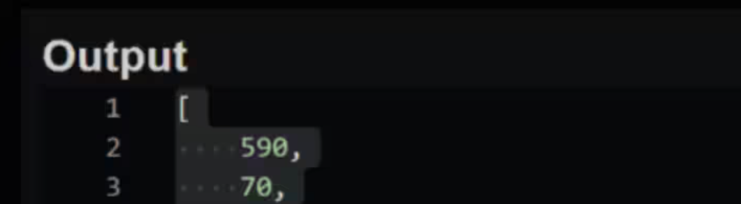

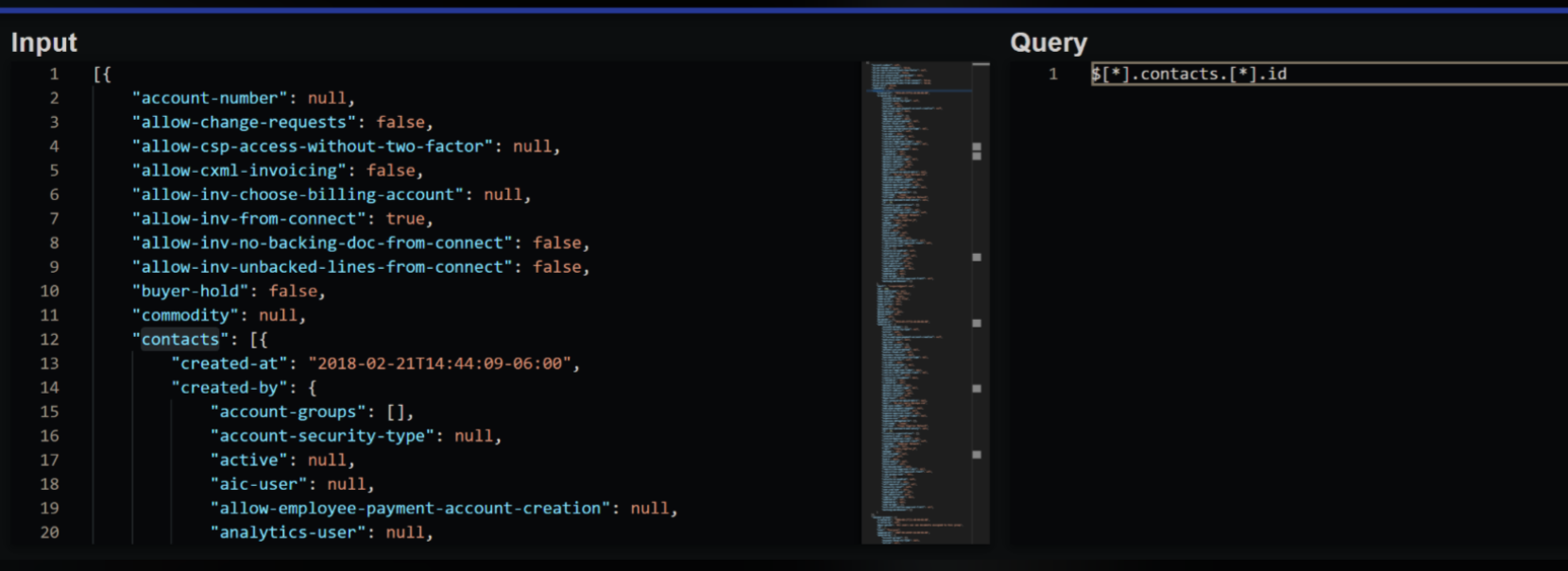

  1. You may have to play with the JSON token path under the JSON Properties tab to ensure you get the data you want parsed out successfully but, once you have achieved that you are ready to connect the "Unpacked Output" to your destination and run your package. As a side note there is a large amount of 3rd party resources to assist in understanding how to parse JSON prior to applying these technical skills to Task Factory. This link is Basics On Parsing JSON  and there are other tools such as validating your JSON through JSON Lint and others to test parsing JSON outside of the application altogether using JSON Query Tool. You can also refer to these screenshots below in playing with the token path to properly parse JSON using the TF Unpack Data Transform Component. (Screenshots 1 & 2 for this step display examples of leveraging a 3rd party tool such as JSON Query Tool to adjust the JSON token path and then parse the Output. Screenshots 3 & 4 for this step display examples of parsing the same JSON script and adjusting the JSON token path the same way with another 3rd party tool and then shows a successful test of the Output.) image.png
          8. While running your package if you find that no rows are being input to your destination, you should use a Terminator Destination to connect the Unpack Data Transforms Output data. You may also want to set the Unpack Data Transforms Error Handling to Fail Component to view any errors that may be causing an issue.
