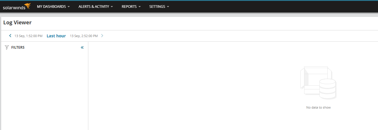

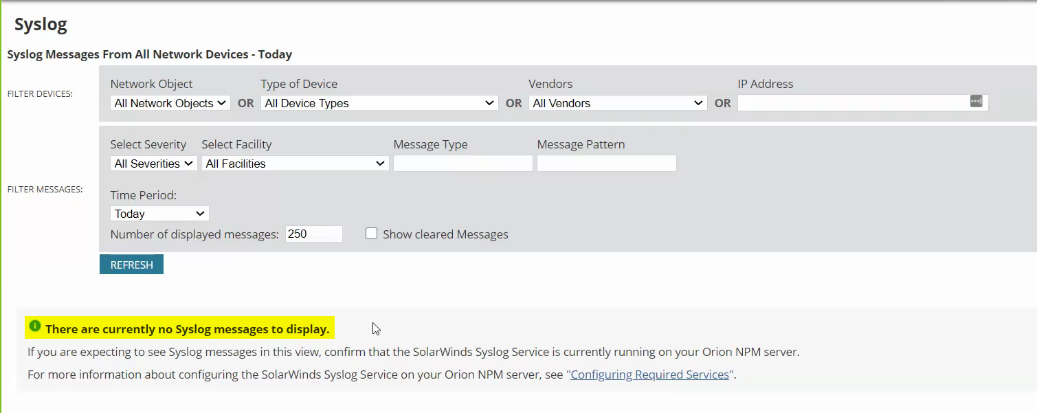

If you are having trouble receiving syslog messages from devices configured to send Syslog messages to your Orion server and are seeing the message below:
Legacy Syslog View
OLV Orion View

  • Devices from which to receive Syslog messages are monitored but are not configured to send Syslog messages to the correct IP address of the Orion server

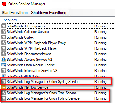

To troubleshoot Syslog issues:
  • Check the Syslog Services if it's running
  •  Verify if default port (514 UDP) is bonded to Orion Syslog Service
