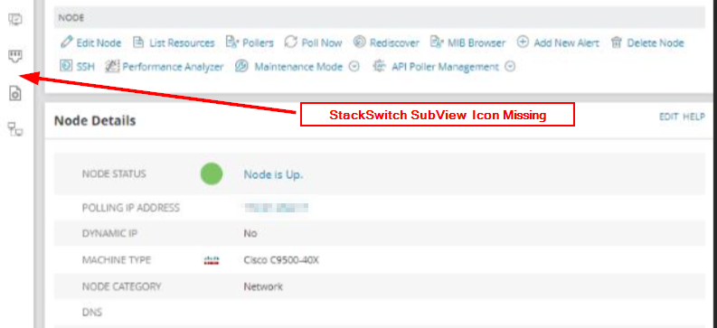

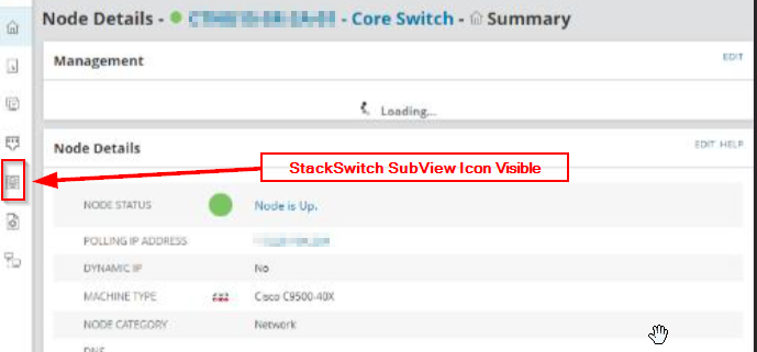

Example: One of the stack switches shows the stack icon on the left-hand side
but the other does not.
Both nodes are recognized as having two switches, as it shows the power supply fans, etc. in the Hardware Health widget.

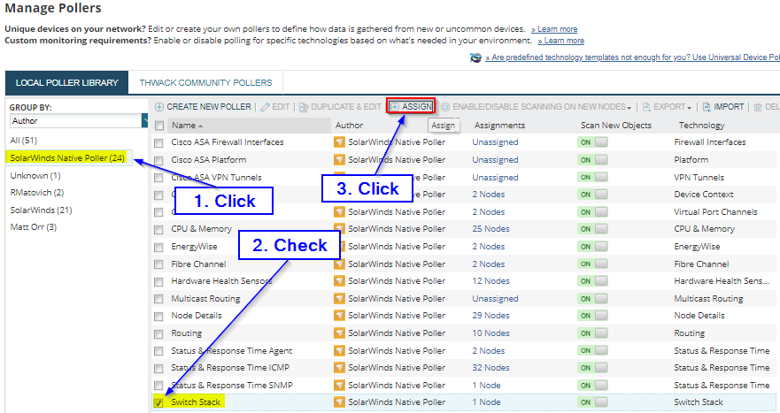

    1. Go to Settings > All Settings > 'Node & Group Management' section > Manage Pollers
    2. In the GROUP BY column on the left side, click on SolarWinds Native Poller

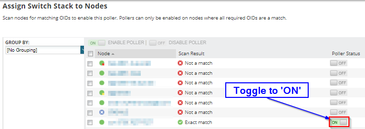

    3. Check the Switch Stack poller, then click on ASSIGN
    4. Search for or find the node not showing as a Switch Stack, and toggle OFF to ON.
