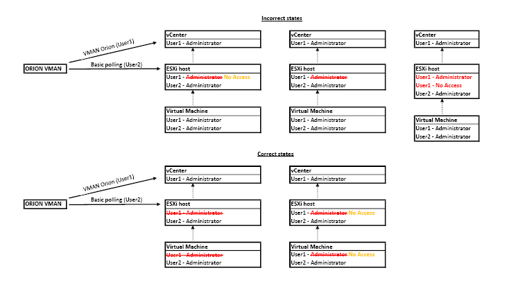

This issue can happen when the following conditions are met:
  • A vCenter is set to be polled through Orion VMAN polling while some of the ESXi host children of that vCenter are set to be polled through Basic polling.
  • The permissions for a user are incorrectly set up in a conflicting manner as follows in two different possible scenarios:
Conflicting roles in settings set manually
For the vCenter:
  • The user is assigned a specific role with at least read access (for example, "Administrator")
For a child ESXi host:
  • A conflicting role is assigned for the user, such as "No Access"
- or -
Conflicting roles in settings with the propagate to children option
For the vCenter:
  • The propagate to children option is checked -- this option will override all other options for child entities, including VMs under an ESXi host with a "No Access" permission.
  • The propagated role (in this case, "Administrator") is manually removed or its access level is changed manually to "No Access". In this case, it no longer matters if the "Propagate to children" option is checked or not, because the manually assigned role will persist in child VMs.
The resulting symptom of switching green and gray status is caused by:
  1. Orion VMAN polling to the vCenter reads "No access" from the ESXi host's credential for child VMs, resulting in gray status for these VMs.
  2. A short time later, the Basic polling to an ESXi host child of the affected vCenter reads "Administrator", resulting in green status.
  3. The behavior will then oscillate back and forth as Orion VMAN polling and Basic polling alternates.
Correct and incorrect permission states chart visualization:

    Fix the permission settings so that the permissions are set correctly for the entire virtual environment:
    1. Correctly set the user permissions for affected vCenters and children ESXi hosts. The permissions must agree with no conflict. For example, a user cannot be given an "Administator" role for a vCenter while also having a "No Access" role for a child ESXi host.
    2. Permissions must be set correctly for the entire virtual environment. For example, if you want to prevent user's access to a specific virtual machine, the user's access must be prevented on all levels: for the parent entities as well as the particular virtual machine.
