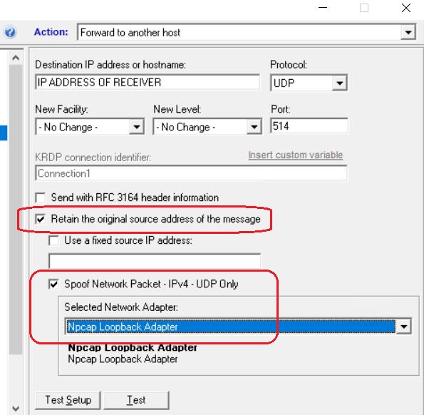

When you forwarding packets in Kiwi Syslog Server, you can use the “Spoof Network Packet” option if you want to retain the original source IP address.
Kiwi Syslog Server
The network packet will be spoofed to appear as though the fowarded message has come directly from the originating devices' IP address, and not the address of the Syslog Server.  Kiwi Syslog Server will use the Selected Network Adapter to send the spoofed UDP/IP packet.
Note:
  • This feature is only available in the licensed version, and requires Npcap 0.9989 or above
  • This option only applies to syslog messages forwarded via UDP protocol with IPv4 address only.
  • This option only applies to syslog messages forwarded via UDP protocol.

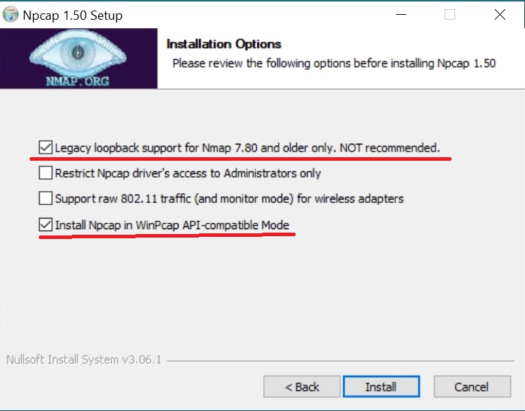

Important Note:
  • During the installation of Npcap, ensure that "Legacy Loopback Support" and "Install Npcap in Winpcap API compatible mode" are checked.
  • Npcap can be downloaded at Npcap release archive page (content provided by Gordon Lyon, available at https://npcap.com,  obtained on November 11, 2022)
  • Nmap 7.9x can be downloaded from Nmap.org page (content provided by Gordon Lyon, available at https://nmap.org,  obtained on November 11, 2022)
(Screenshots property of © <2022> https://npcap.com/)
Note:
  • If Legacy Loopback Support is not available from the Npcap installation, you will need to use the Nmap7.9x setup file to install Npcap with Legacy Loopback Support. This will enable to the "Spoof Network Packet - IPv4 - UDP Only" option on Kiwi Setup.
Test button:
Use the Test button to send a test Syslog message to the host(s) specified.
Note:  If the "Spoof Network Packet" option is used, then the "Original Address=" tag will not be used.  The Syslog packet will be forwarded to the destination address as though it has been sent from the originating IP address.
