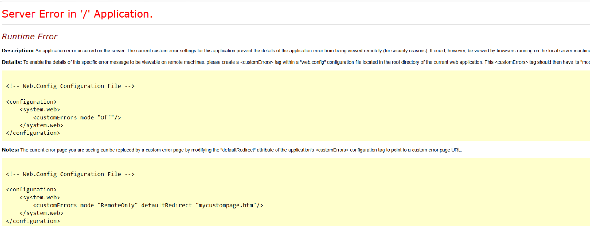

Whenever a server restart is performed on the Main Polling Engine, all SolarWinds services return to running state, but the SolarWinds Platform Web Console does not open and an error page is displayed instead of the login page.
