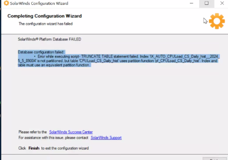

During execution of the SolarWinds Configuration Wizard, users may encounter an error similar to the following:
ERROR DBConfigProcessor – TRUNCATE TABLE statement failed. Index 'IX_AUTO_CPULoad_CS_Daily_hist__2024_5_5_89004' is not partitioned, but table 'CPULoad_CS_Daily_hist' uses partition function 'pf_CPULoad_CS_Daily_hist'. Index and table must use an equivalent partition function.
Index name  and affected table might vary.
This occurs during the Database Configuration phase, specifically when the Configuration Wizard executes the database setup scripts located in the DatabaseSetup\PreTimeSeries directory. The error indicates a mismatch between the partitioning of a table and its associated index.
The table CPULoad_CS_Daily_hist is partitioned using a specific partition function (pf_CPULoad_CS_Daily_hist), while a custom or non-standard index (in this case, IX_AUTO_CPULoad_CS_Daily_hist__2024_5_5_89004) is not partitioned.
