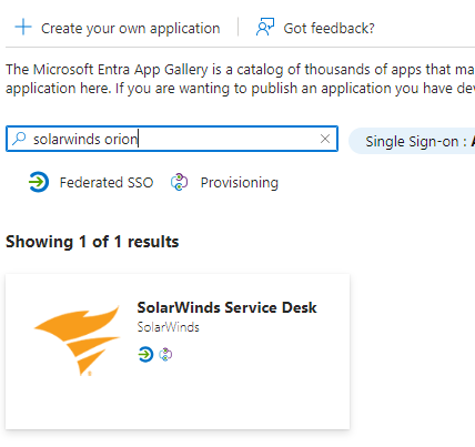

"SolarWinds Orion" app is missing in Azure Portal when setting up SAML for the SolarWinds Platform
Solarwinds Orion app needed for SAML integration is missing
7/11/2024 4:07 PM
10/21/2025 8:43 PM

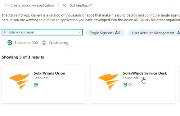

When following the steps to Configure Azure AD for single sign-on login, the "SolarWinds Orion" app is missing if you search for it.
Configure Azure AD for single sign-on login to the SolarWinds Platform Web Console

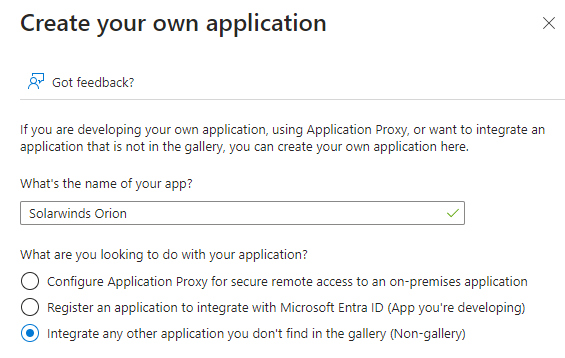

This issue is fixed in SolarWinds Platform 2025.4. Consider upgrading your environment. If you can't upgrade, use the workaround below.
  • navigate to Enterprise Applications in Azure
  • click “Create your own application“, type the name of the application, and select “Integrate any other application you don't find in the gallery (Non-gallery)“

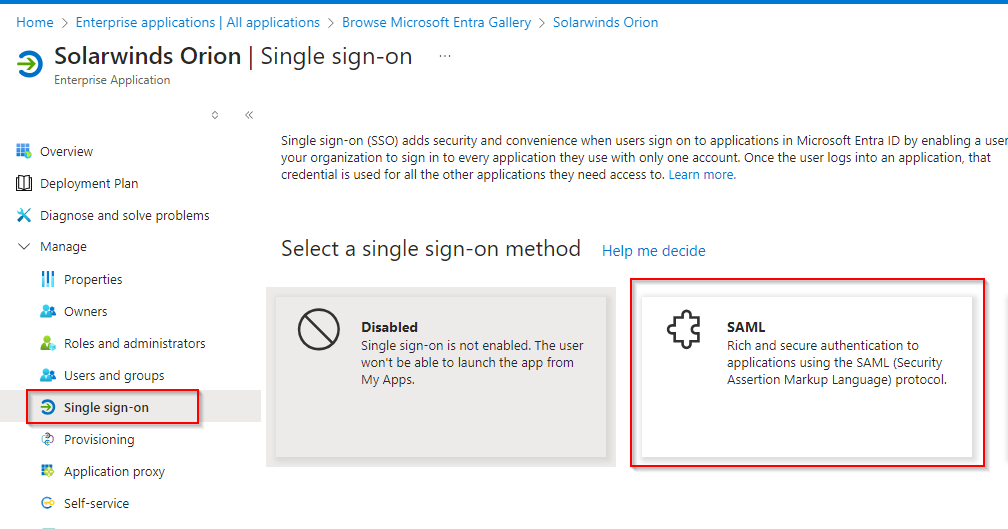

  • select “Single sign-on “ in the left panel and select SAML method.
  • now you can proceed with the fourth step of Step 2: Configure Azure AD to be able to communicate with the SolarWinds Platform- Configure Azure AD for single sign-on login to the SolarWinds Platform Web Console
