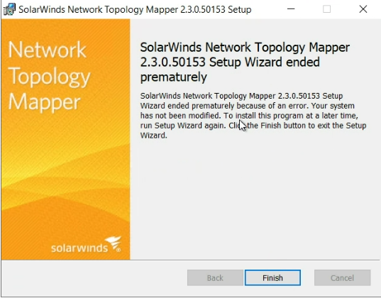

Solarwinds Network Topology Mapper 2.3.0.50153 Setup Wizard ended Prematurely Error when Installing or Upgrading NTM 2.3
This article describes the resolution for the error "Solarwinds Network Topology Mapper 2.3.0.50153 Setup Wizard ended Prematurely" when upgrading or installing NTM 2.3.
There are instances in which upgrading the NTN 2.2 to NTM 2.3 or freshly installing the NTM 2.3, an error appears, "SolarWinds Network Topology Mapper 2.3.0.50153 Setup Wizard ended Prematurely".
As per the NTM 2.3 Release Notes, before upgrading to or installing the NTM 2.3, the MSQL Server Compact 4.0 must already be installed in the NTM Server.
Moreover, you cannot install both NTM and SolarWinds Hybrid Cloud Observability on the same machine. If installed on the same machine, one of the products will not work.
- Missing MSQL Server Compact 4.0. as a pre-requisite requirement.
- Unable to install in a Server without SolarWinds Platform products using Windows OS GUI.
