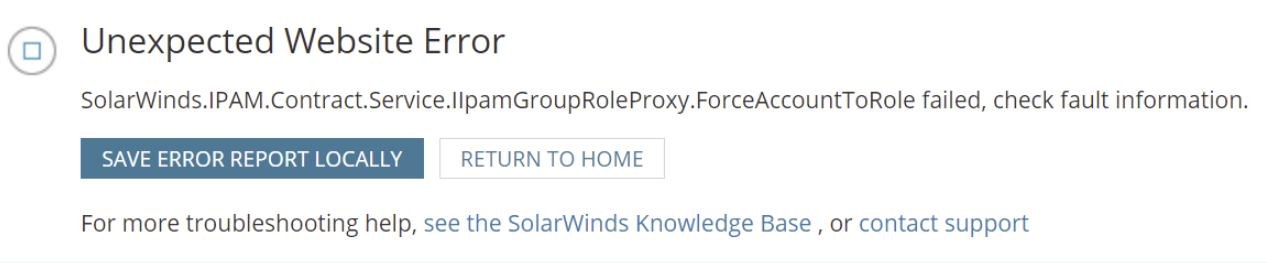

While adding or editing users or groups in the SolarWinds web console, the following error message may appear:
Solarwinds.IPAM.Contract.Service.IIpamGroupRoleProxy.ForceAccountToRole Failed
Sample Image:
