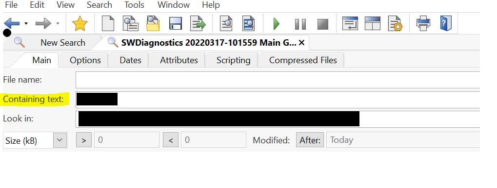

Resolution 2:
Scenario: You can't find the old service account mentioned on the event ID anywhere from the Orion. This account still being used somehow in Orion even it doesn't exist anymore.
Here's what to do where to locate this user:
  • Gather diagnostics
  • Use Agent Ransack , then search the full name of the account in "containing text":image.pngAfter starting the search, select any file on left pane and you will see the results on the right pane of the agent ransack window.
  • From there, you will get the exact information or hint where the account being used in Orion.
