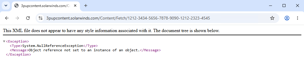

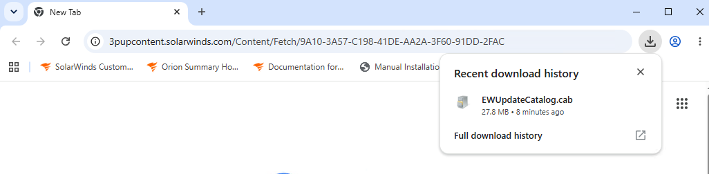

  • The issue can be confirmed by attempting a manual download of the catalog using the following URL based on the license key:
    https://3pupcontent.solarwinds.com/Content/Fetch/<license key>, example https://3pupcontent.solarwinds.com/Content/Fetch/1212-3434-5656-7878-9090-1212-2323-4545.
  • A valid license will download the EWUpdateCatalog.cab  file after a brief delay
  • An expired license will give an error:
    “This XML file does not appear to have any style information associated with it. The document tree is shown below.”
