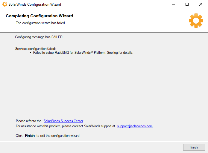

If this issue occurs, the Configuration Wizard fails with the following error message:
Failed to setup RabbitMQ for SolarWinds Platform
