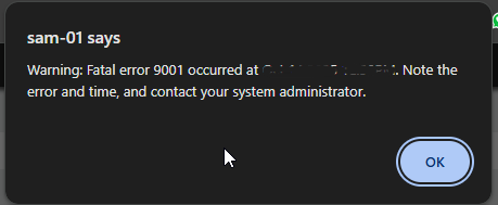

SolarWinds Platform Web Console error "Warning: Fatal Error 9001 occurred at MM/DD/YYYY HH:MM. Note the error and time, and contact your administrator."
The SolarWinds Platform Web Console may display an error message: Warning: Fatal Error 9001 occurred at MM/DD/YYYY HH: MM. Note the error and time, and contact your system administrator.
12/1/2025 5:36 PM
12/1/2025 5:36 PM
Additionally, you may receive a warning within the WebUI stating that "Database maintenance started on MM/DD/YYYY has finished with errors."
Similar errors can be found in the  Orionweb and swdebugmaintenance logs in C:\ProgramData\SolarWinds\Logs\Orion.
