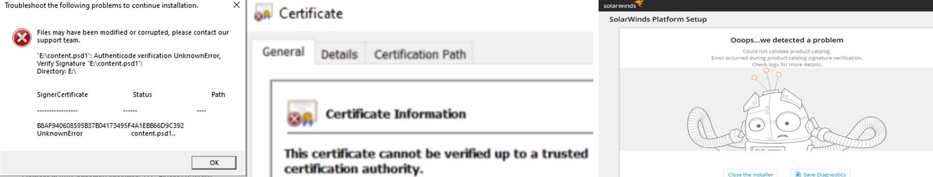

Example of the error users see during installation:
Figure 1: Product catalog signature validation error displayed by the installer.
