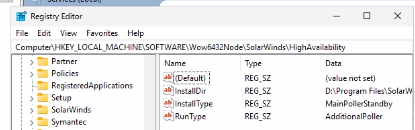

4. Correct the Run Type on the Intended Standby (D2)
  1. Remote to the Main Poller Standby server (D2).
  2. Stop all SolarWinds services, including the HA service.
  3. Open Registry Editor on D2 and navigate to the Orion core key (for example):
    HKEY_LOCAL_MACHINE\SOFTWARE\SolarWinds\Orion\Core
  4. Check the RunType value:
    • It is currently set to AdditionalPoller.
  5. Change RunType to MainPollerStandby.
  6. Close Registry Editor; do not start services yet.
Note: At this point, if you run Config Wizard on D2 alone, the RunType may revert to AdditionalPoller. The remaining steps are required to prevent that regression.

6.2 Reset RunType on D2 (Again, If Needed)
  1. On D2, re-check the registry:
    • Confirm RunType is set to MainPollerStandby.
  2. If it reverted, change it again to MainPollerStandby and leave services stopped.
