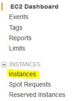

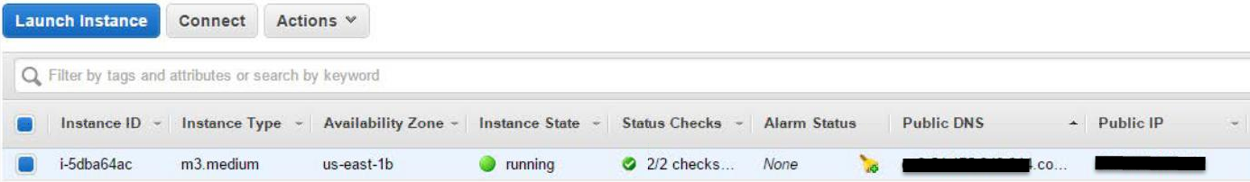

You can launch DPA with the public DNS or public IP of your SolarWinds DPA server, which you can find on the Amazon EC2 Instances page. See Launch SolarWinds DPA on Amazon Web Services (AWS) on a Linux AMI for more information.

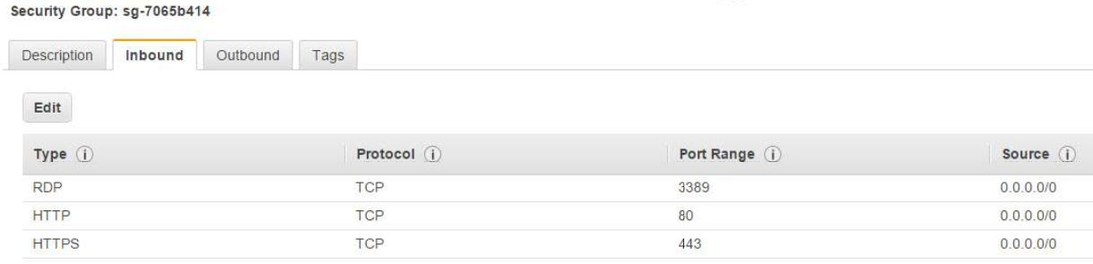

To resolve this issue, perform the following steps:

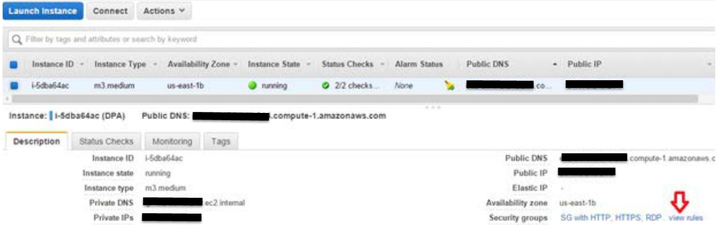

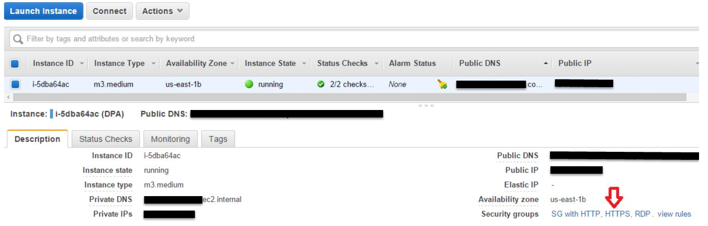

Log in to your EC2 console and locate your EC2 instance.
To verify that the security group rules allow for HTTP and HTTPS access, click on the view rules link and inspect the security group’s inbound rules.
You should see inbound rules for HTTP and HTTPS from all public addresses (CIDR: 0.0.0.0/0) or, if you restricted the traffic to only your IP address, from CIDR: X.X.X.X/32 where X.X.X.X is your workstation’s public IP address.
Below, you see HTTP and HTTPS inbound rules allowed for all sources. In this scenario, this security group also had opened access via RDP to allow you to easily connect to the instance from your desktop, but that rule is not enabled by default for DPA in AWS.

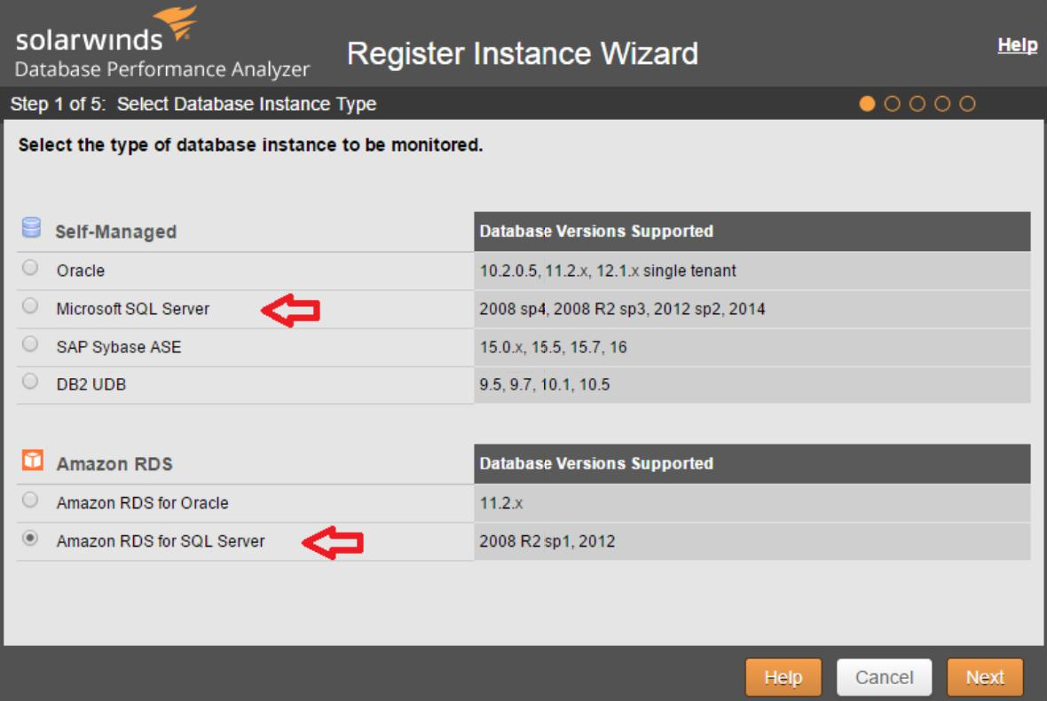

2. Are you selecting the correct database engine?
DPA supports a variety of database engines, including Oracle and SQL Server, whether on EC2 or on RDS. Make sure to select the right choice in the wizard. For example, if you installed the database yourself on EC2 instances, then select the database choices of the top, Self-Managed group. If your database is running on RDS, select the ones on the bottom group.

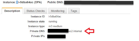

For databases running on EC2
If your target database is running on an EC2 instance, DPA running on AWS can access it through the internal IP address of your instance.
Simply copy and paste that into the Server field on Step 2 of the Register Instance Wizard.

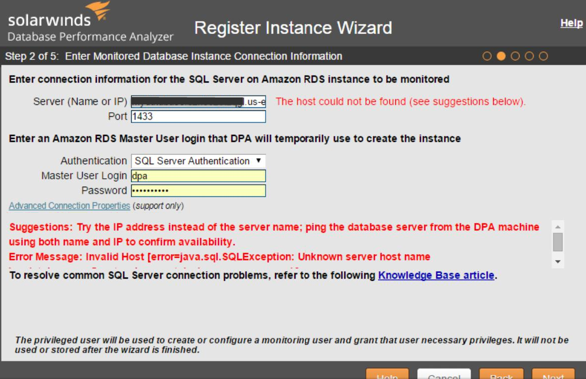

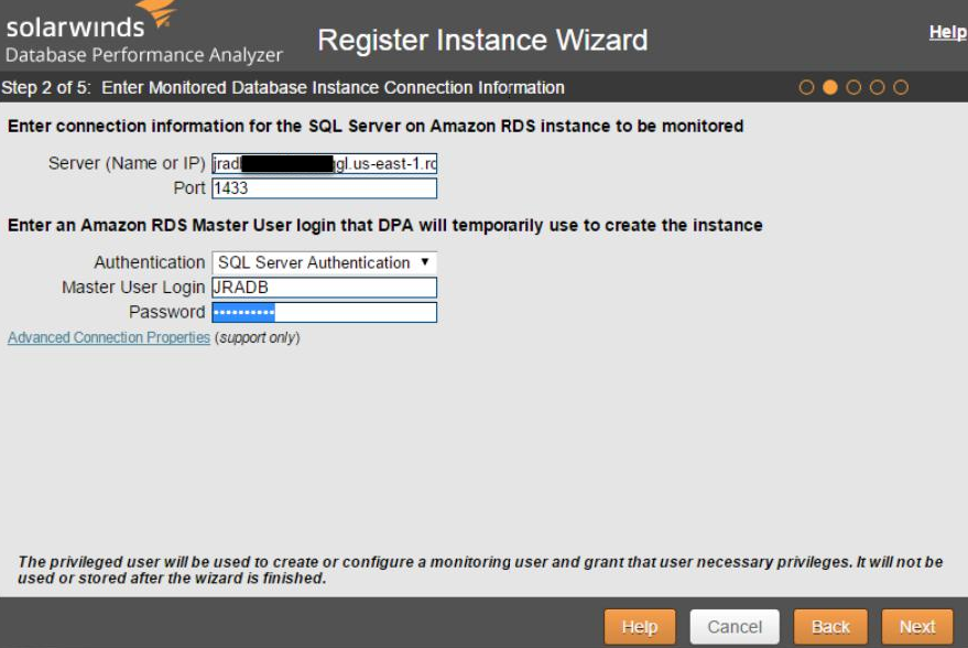

For databases running on RDS

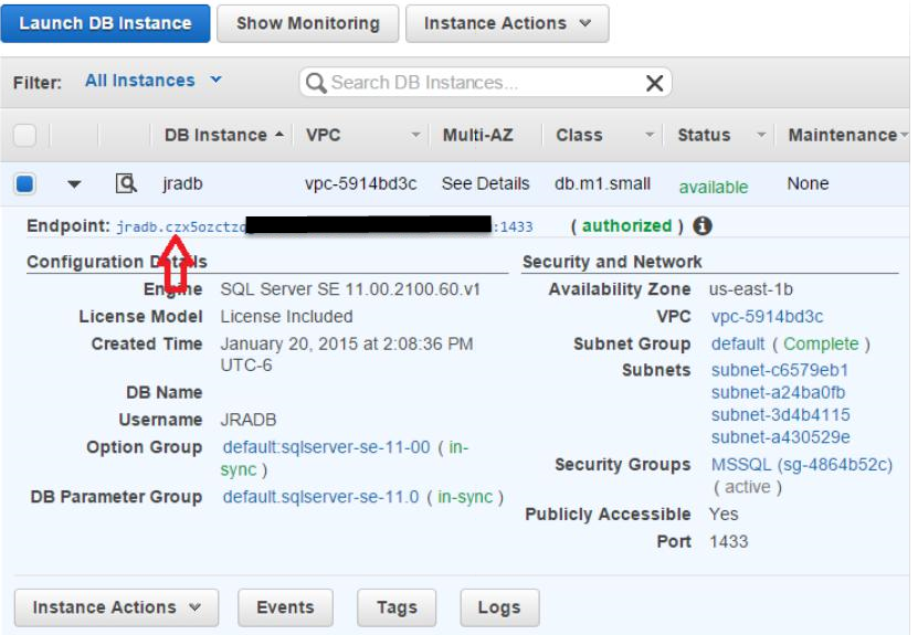

If your database runs on RDS:

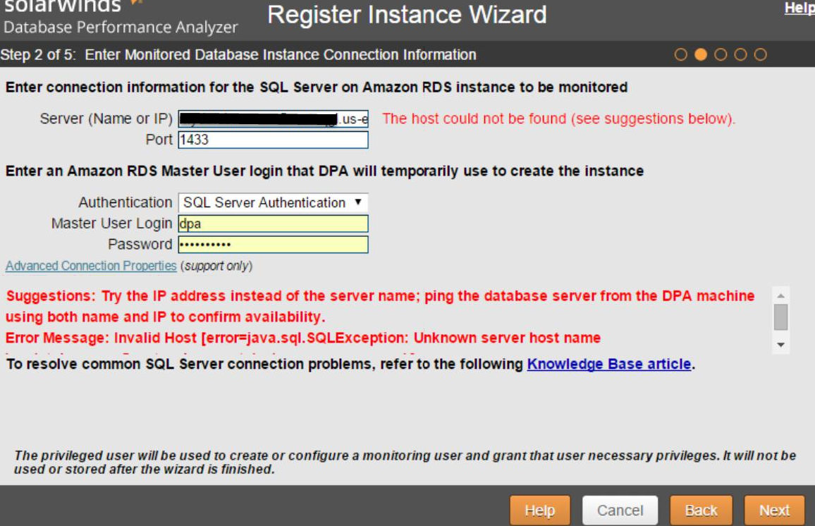

Go to the RDS console and copy the instance endpoint.
Paste that value into the Server field in Step 2 of the wizard. Make sure to remove the colon and port number at the end of the string (in this example, remove :1433).

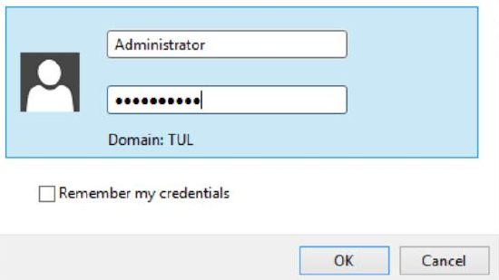

4. Are you using the right credentials?

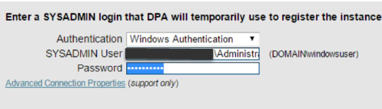

When you attempt to register a database instance in Database Performance Analyzer, the software asks for a master user login and its password. The software requires the DBA privileged user in order to create and configure a monitoring user and grant that user necessary privileges. (Note that this information is not stored and can only be used during the duration of the wizard.)
Ensure you have the appropriate user ID, password, and authentication mode (for example, Windows or SQL authentication in the case of SQL Server).

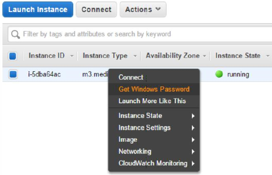

EC2: Make sure your EC2 instance is running and SQL Server is operational
If your database is running on an EC2 instance:
- First make sure that the instance is running.

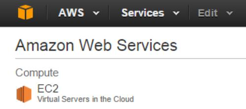

Go to the EC2 console in AWS.
- Click EC2 under the Compute category.
Look for your target EC2 instance running your database. It should be in a “running” state like the one below. If it is in “stopped” state, restart your instance by right-clicking it and selecting Start.

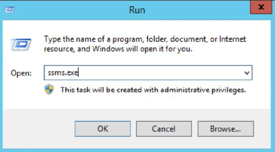

If the instance is in “running” state, log in into the server and see that your database is running.
Here, we will assume you have SQL Server Management Studio (SSMS) running on your SQL Server box. If SSMS is not running, connect to your database using SSMS from your desktop. First, get the password to get into your EC2 instance. You may have already changed the original password assigned by EC2. If not, right-click on the instance and select Get Windows Password.

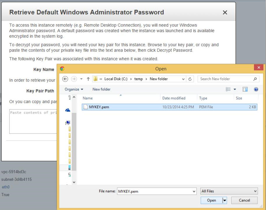

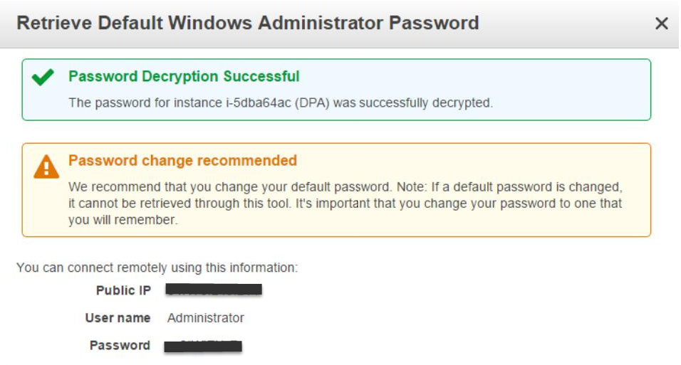

You must retrieve your key. If you lost your key file and do not remember the Windows password to your instance, you will not be able to connect to it.
Once you have given the AWS console your key, you can click Decrypt password and see it:
Copy the password to your clipboard and run a Remote Desktop Connection. Sign in as an Administrator using that password.

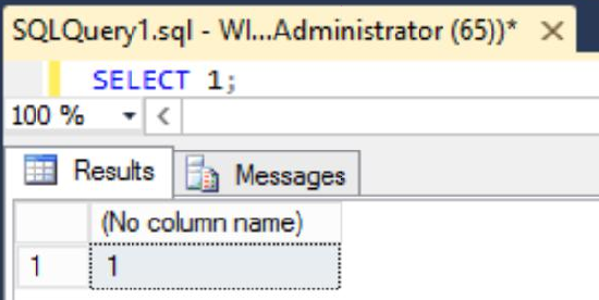

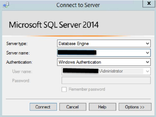

Once you login to your EC2 instance, run SQL Server Management Studio.
You should then be able to connect to your database instance and do something simple. Make sure to use your target database server name (not the name of your DPA EC2 instance) when connecting.

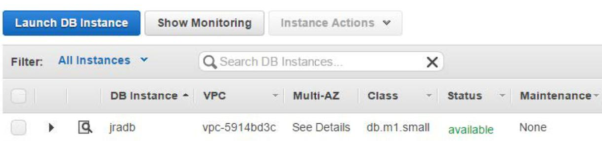

RDS: Make sure your RDS instance is available
If your database is running on RDS:
Go to your AWS console and select RDS under Database.
Click on the desired Instances and you should then be able to see your instance. Ensure the instances are in available states.
As in the EC2 case, connect to it using your favorite database client and ensure you can see the database running.
If somebody rebooted your database,then simply wait until the database comes back up.

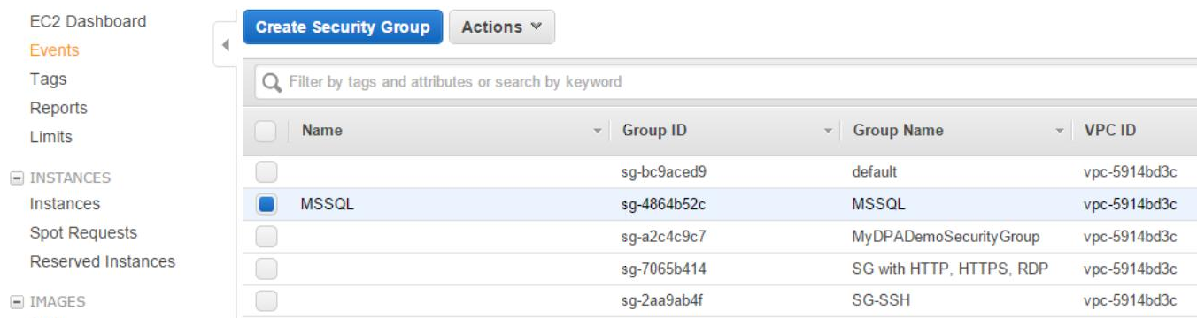

It’s a good idea to take a look at all the security groups we have. Here is the current setup:

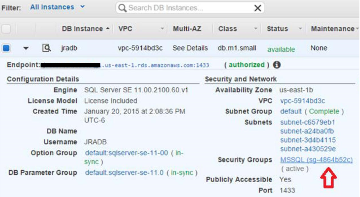

We will use RDS for this example. Let’s go to the RDS console. Here is the RDS instance that we are trying to connect to.

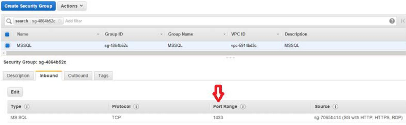

The security group associated with this RDS instance is called MSSQL, with the ID sg-4864b52c. Click that link to go to the security group’s configuration. We want to make sure that that group is not simply named MSSQL, but that in fact it allows inbound SQL Server traffic.
As we can see below, the MSSQL security group sg-4864b52c actually has an inbound rule for TCP MS SQL traffic on port 1433 from the security group sg-7065b414. If you go back to the first error screen, you will see that we were in fact trying to connect on the correct port 1433.

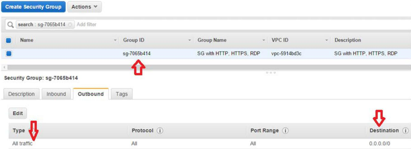

We have now verified that the database instance allows inbound MSSQL traffic from source sg-7065b414. Let’s now verify that the Database Performance Analyzer Server is part of this other security group sg-7065b414source and that it allows for outbound SQL traffic. Go back to the EC2 console and select your DPA EC2 instance. You then see the security group associated with it. Click that link.
You are now at the security group of the DPA EC2 instance. Here, you have to confirm two things. First, you want to confirm that the EC2 instance is in fact assigned to the Security group defined as source in the security group of your database instance, which we identified as sg-7065b414. Here we can see that the EC2 instance is in fact assigned to that security group (we also could have seen the description, but it’s best to check the Group IDs since descriptions can be duplicative). Second, we want to make sure that this security group sg-7065b414, which is assigned to the EC2 instance, does allow for outbound SQL traffic. We see in this case that it allows for all outbound traffic to all destinations.

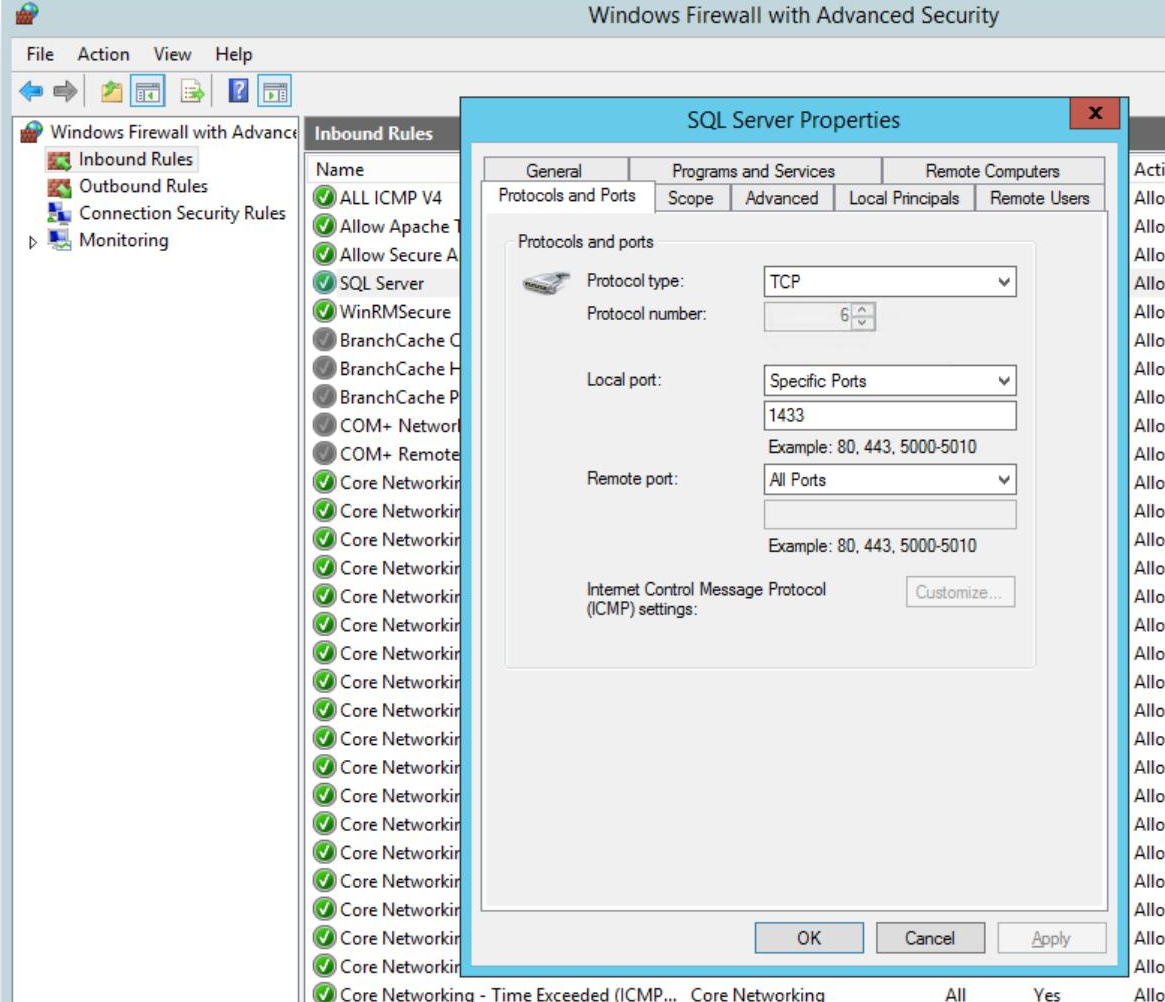

7. Is your database firewall properly configured?
If your database is running behind a firewall, make sure that it allows the SQL traffic of your database engine. More commonly, if your database instance is running on an EC2 instance running Windows, ensure the appropriate Windows ports are active in Windows firewall. Below we see that port 1433 is open in the EC2 instance for inbound traffic to the target database. It is possible that someone might have also modified the Windows firewall settings.
Verify that the Windows firewall rules on the EC2 instance running Database Performance Analyzer have not been changed. When provisioning the software on AWS via the Amazon Machine Image (AMI), we ensure that inbound ports for HTTP and HTTPS are open for inbound traffic so that you can use the web client from your desktop. Since the default for Windows Server in EC2 is that all outbound traffic is allowed, this is an unlikely possibility, unless somebody actually added restricted outbound rules to the Windows Firewall of your EC2 instance running DPA.

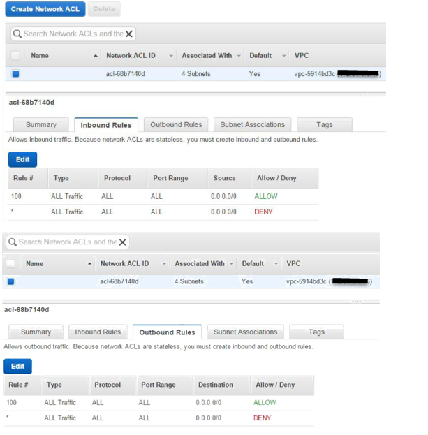

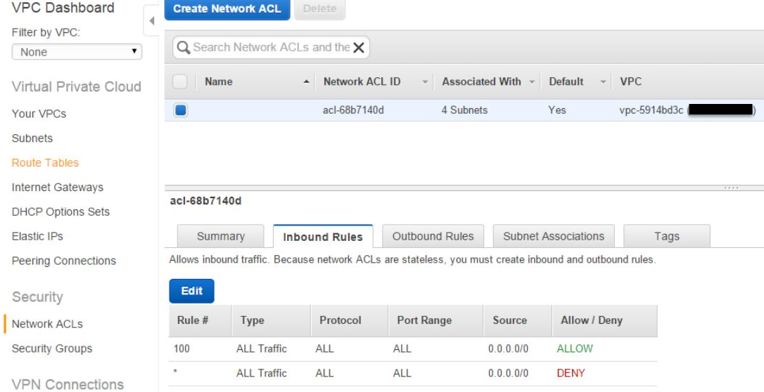

8. Are your VPC ACLs properly configured?

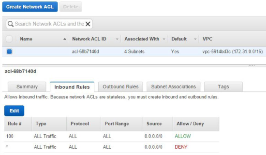

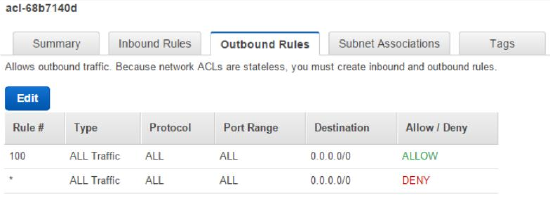

In addition to Security Groups, AWS has an extra level of security in VPC called Network ACLs. Network ACLs provide additional firewall capabilities to control traffic in and out of subnets. ACLs rules are stateless. This means that if your configuration uses ACLs, you must ensure that both inbound and outbound rules exist.
To check, and, if necessary, apply these rules, perform the following steps:
Click VPC under Networking in the AWS console.
In this simple setup, all traffic is allowed.

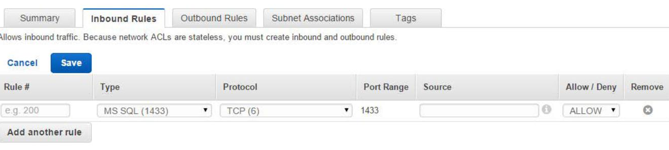

If your setup does not look like the figures above, click Edit on the ACL and ensure that both a MS SQL outbound rule AND an MS SQL inbound rule exist. Again, ACL rules are stateless, so you must edit both the Inbound Rules and the Outbound Rules in the ACL.
For more information on VPC ACLs, see the “Network ACLs” documentation from AWS at http://docs.aws.amazon.com/AmazonVPC/latest/UserGuide/VPC_ACLs.html. (© 2018 Amazon Web Services, Inc or its affiliates, available at docs.aws.amazon.com, obtained on November 21, 2018)
