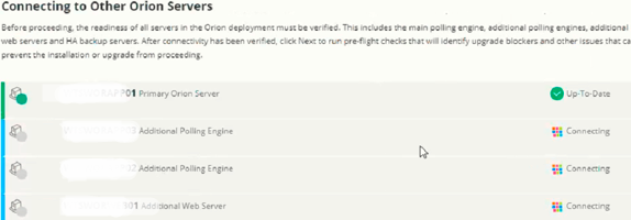

Scenario 2:
In another scenario, the service was installed however the Additional Polling Engines have a newer version than the Main Polling Engine and the Centralized Upgrade console shows the following status:

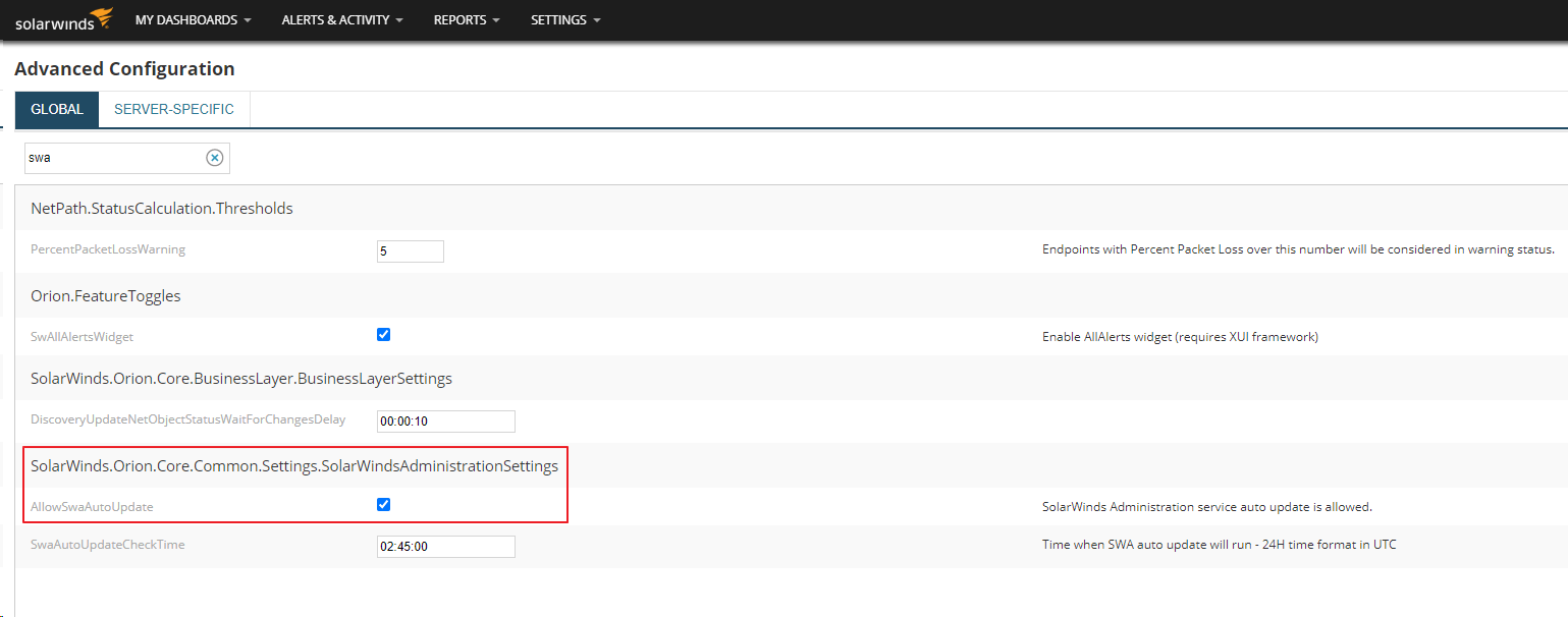

For Scenario 3:
The version of Administration Service should be the same as the installer of the SolarWinds Platform.  To prevent the automatic update of SWA perform the following the steps:
  1. Access Orion Advanced Configuration page: http://<Orion_IP_Address>/Orion/admin/Advancedconfiguration/global.aspx
  2. Search for SWA
  3. Uncheck AllowSwaAutoUpdate
  4. Click Save

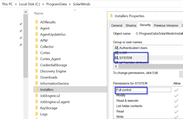

Step 2:
Ensure the System Account has full control over the installers folder
Default location: C:\ProgramData\SolarWinds\Installers
