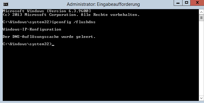

  • Empty the DNS resolution cache on both the ARM server and the connecting mobile device:
    • Open the CMD prompt.
    • Run the command:
      ipconfig /flushdns
      (Screenshot property of © 2020 Microsoft)
  • If this does not resolve the issue, add the IP address of the mobile device into the local DNS resolver (hosts file) of the ARM Server.
